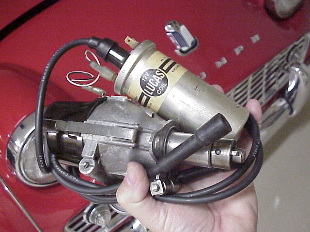

Me too. For these cars you can just about hold an entire ignition system in one hand.
If you set it up beforehand (set gap & timing) it is just a drop in to get you going again.
