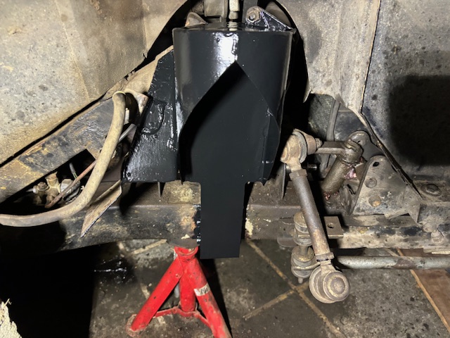

slow progress, spring tower de-rusted and repainted. One thing I'm not sure of, there was some sort of circular flange protruding about 1/2 inch from inside the top of the tower to locate the rubber spring collar on; there was little left so I just dremeled it out for now.
You are correct, Doc. There is a doubler with a locating flange that should be inside your tower. I do not have a great picture, but you should get the idea from these partial pics
thanks - I don't have the tools or talent to fabricate that flange much less weld it in upside down, so will be for the future. I think with the damper bolted in place and the rubber collar seated it will all be good. will be interesting to see if the other side is the same

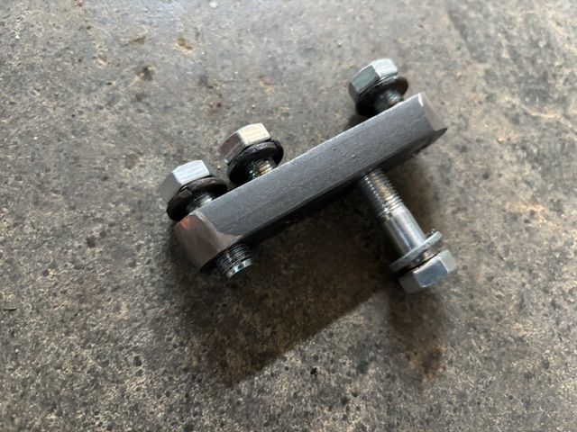

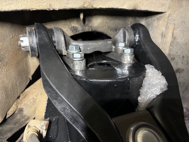

Slow progress getting parts together but I got some TR6 upper wishbones, new fulcrums, trunnions etc and decided to have a go at making some trick brackets to bring in about 1.5 deg negative camber based on an idea in the TR Register. The brackets offset fulcrum back by 18mm, but then the fulcrum is reversed bringing the offset to 12mm to achieve the negative camber. Trial fitting and the assembly and clearance looks good.
You are overthinking camber. The control arms can be slotted to allow the BJ to be adjusted inboard.
A custom washer is then fabbed up to strengthen the arm and hold the setting. Then it can be tack welded
if desired. This 1/4 inch gets you 1.5 degrees neg camber. It is also a fix to remove a pull due to cross camber
Mad dog
Overthinking is one of my vices unfortunately ;-P
According the the information available, it looks like the upper pivot point needs to be moved 1/2" or 12mm inwards to change the camber from +1.5 to -1.5 degrees at standard ride height. I'm not sure how to slot that much into the a-arms without a lot of modification to extend the inner shoulders of the a-arms where it meets the ball joint. I think the slotting could be used to fine-tune the adjustment a few mm but not make such a large change.
Imagine a heavy washer ,oblong with 2 holes ,just wide enough to set into the arm.
There are limits as to how far this can go, but it is a solid way to modify the arm. You need 4 of
these washers, and it is not too hard to do. Perhaps it wont be enough to make 1.5 deg but it is a step
in the desired direction. I have mainly done it to equalise a cross camber issue, on a car just a bit out of spec.
Mad dog
