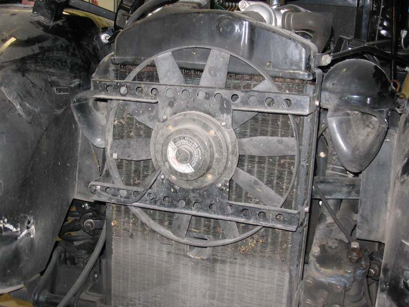

I installed a 12" diameter Kenlowe fan in my 1958 TR3A about 18 years ago with a simple switch hooked through a relay under the dash. It works fine. 12" is the biggest that will fit. It's up quite high so I can still use the hand crank.

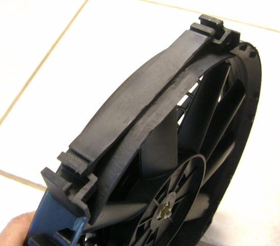

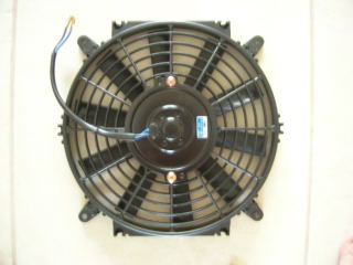

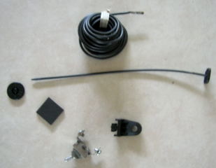

The Aussie electric fan Randall mentions are Davies Craig brand, and I use the Range Rover size as a pusher. It has even thinner blades than Don's, and doesn't inhibit much natural air flow through the grille at highway speed.

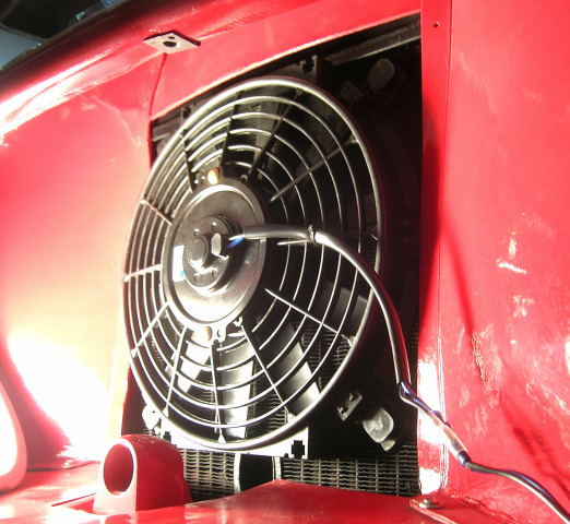

Got the fan mounted!
It was an easy install.
I removed the front bumper and unscrewed the grille and let it hang.
The smaller 10" fan had plenty of room to fit through the opening.
Had to modify the plastic shroud a little to miss the upper tank. Now it fits tight against the fins and misses the crank hole.
Not sure were to get power from under the dash for the switch yet.
Since my drivers side horn is not working,
maybe I could use the large brown/green wire?
Lyle
