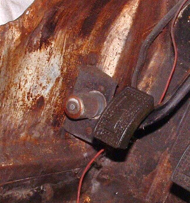

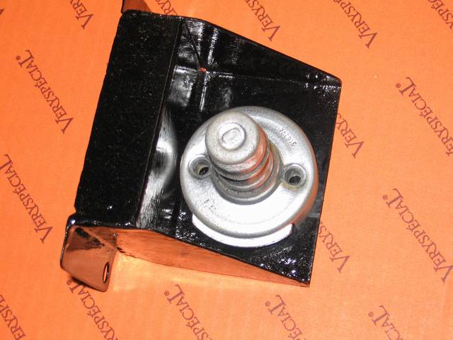

Do these pictures help?
Nick, it looks like you have that bracket upside down...you must have tiny feet to get in there and work that dimmer switch.
No, Don Elliott thought that before, but it won't fit the other way around. It also acts as a foot rest and you can just slide your foot to the right to dip the lights. My car is TS64566L, so not sure if it is an early one or a late one, but as the rest of the car is pretty original, I think that is how it came out of the factory.
This is like the bracket and switch I put on the late TR3A (TS 81551 L) that I restored. But I don't remember who sent in the photo.
Nick's switch body is the smaller diameter switch like mine on my early TR3a (TS 27489 LO).

The later cars might have had those steel walls surrounding the switch; but I'm fairly sure the earlier cars had the bracket turned the other way.

I don't think I've paid a moment's attention to my high beam switch/bracket, other than it works. Here's another view...
Don's picture Is exactly what mine had. Terrible design for my big feet. I figured it was homemade till I saw these pictures.
