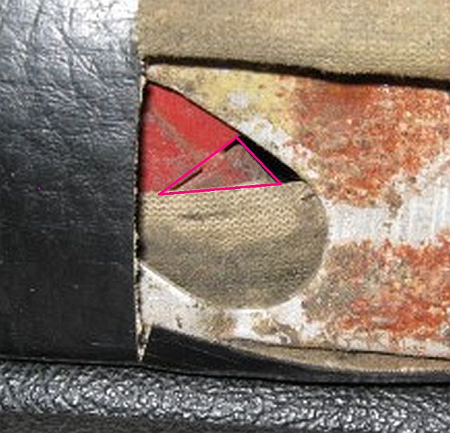

To see the rail itself, I cut away some of the vinyl. The underside of the rail, where the grip is screwed, seems to show a steel assembly - not wood. The screws are tightly in and won't turn more, but they're obviously not "all the way in".
Is this right? The grip handle screws look like wood screws, but they sure don't hold the grip handle correctly "flush" with the dash rail. Can't open the glove box with the handle mounted.

Here's what lies under the vinyl at one of the mount points. Looks a bit "creative" -

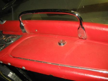

Here is how mine is attached on my earely 1958 TR3A (TS 27489 LO) with the wood screws into the wooden top-rail.

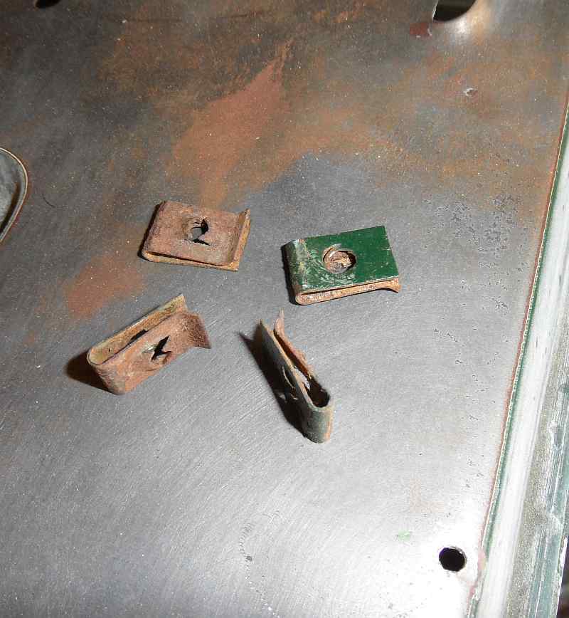

I think you should have the clip nuts, as Jer described. That is what TS39781LO had. In fact, looking at your photo, I am almost certain I can see the corner of one of those clip nuts, peeking out from behind the vinyl inside the larger oval hole.
The wood rail has the holes in a slightly different location than the later metal body does.
The proper screws for the clip nuts are "Parker Kalon" which aren't quite the same as sheet metal screws. But I think you should be able to get by with a #10 flat head sheet metal screw, 3/4" long.

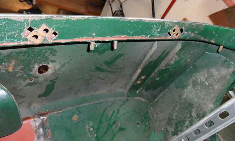

Here's some more pictures.
The clip slides into the rectangular holes. The same holes are on the drivers side, and mine had clips in both sides -almost like built in spares.

This is very interesting, and the pictures are a great help. But my dense brain is having trouble seeing how these "movable" clips could hold my grip handle solidly.
I can see how the clips might go in those "slots", but what holds the clips tight, so the grip handle doesn't move around?
Also, are we saying that the two pairs of holes I see in my rail now, which match the holes in the grip handle, are not to be used?
Thanks.
Tom
Tom,
The clips slide into the dash so the flat side is down (on the underside of the dash) while the smaller/threaded/slot faces up (and on top of the dash). (The clip sandwiches the dash.) The screw goes (in this order) through the handle, then through the capping, then through the larger hole of the clip, then through the dash, and then threads into the smaller hole of the clip. It will secure both the capping and the handle when installed this way. Your picture seems to indicate the handle was secured to the capping, which will not be very strong.

Tom - Just for info, if you re-check the position of my grab bar in the photo above with your photo, you will notice that my grab bar (red vinyl photo) is more to the center of the TR than where yours is located. Mine is the original grab bar secured with the original wood screws (rechromed in 1990) into the original holes in the original wooden piece that I have going across the top of the dash in my early 1958 TR3A.
The position of your bar is interesting Don. My 58 is not like that mine centers over the glove box. I am glad you posted that because you are the original owner and I doubt if someone else had shown me that I would have listened. When I restored my 61, I used a 58 parts car for the rail and handle thinking they were the same. I recover the rail and everything. Then when I went to install it, I noticed the rails are different. The wood one is not as deep by about Âľ of an inch and the handle would not the glove box open. I had saved the 61 one stuff and recapped the rail and used that handle even though it was pitted, and now all the holes line up and the glove box opens. The cars are different.
