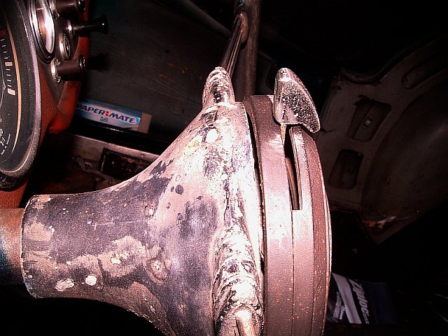

I see you have a TR3 - what is the space there? Is it really close? 1/8"?
Thanks again
Jim
It's less than 1/8", about 3/32.
Milling down the shoulders may not be a good idea, though. The grub screws have to pinch that plate/flange against the shoulders, to make the canceling mechanism work. If you move the surface of the shoulders, I suspect you'll also have to move the grub screws.
Here's a shot of mine at the moment. Obviously I need to install an interior ... RealSoonNow :laugh:

Thanks a lot for the pic Randall.
Just to follow up - it turns out the control head I got from TRF was almost perfect dimensionally aside from one small deviation. The hang up was that the control head flange that rests against the shoulders inside the steering wheel hub was about 0.030" diameter too large. The original was 2.999" and the replica was 3.030" - or thereabouts. Just enough to prevent it from sitting all the way down.
A little patient filing and she sits down correctly. No big deal. Looks great now!
