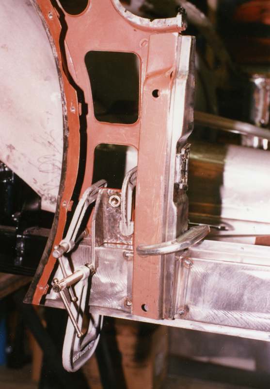

I'm in need of some close up pictures of a "B" post without the rocker installed. It is so nice out I'm cutting out the outer rockers. There is so much built up weld at the bottom of the post that I'm having difficulty knowning where to cut to salvage as much of the post as possible. There is no rust so I'm trying to save metal.
Gordo
Re: TR3A "B" post

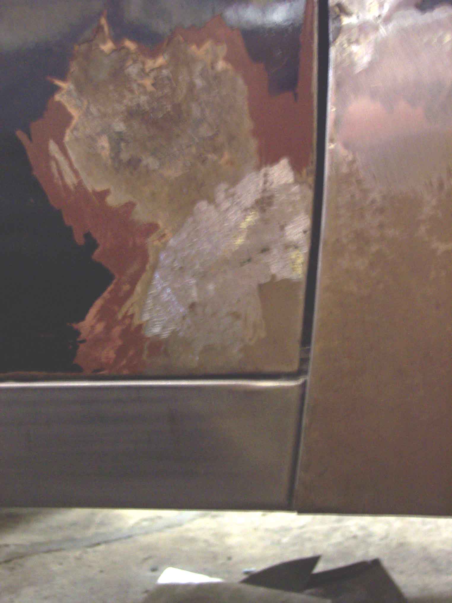

Here is one from a late TR3A I finished in 2006.

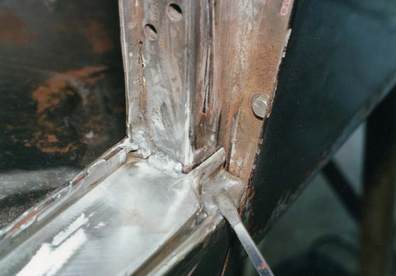

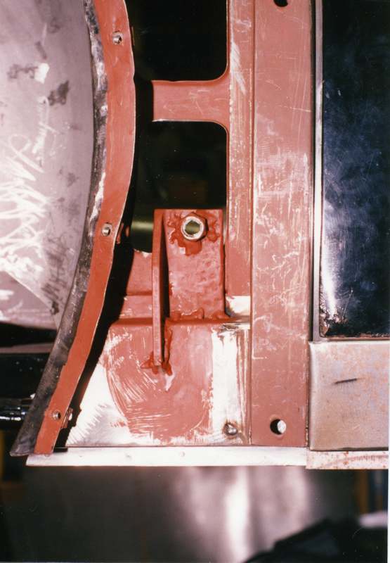

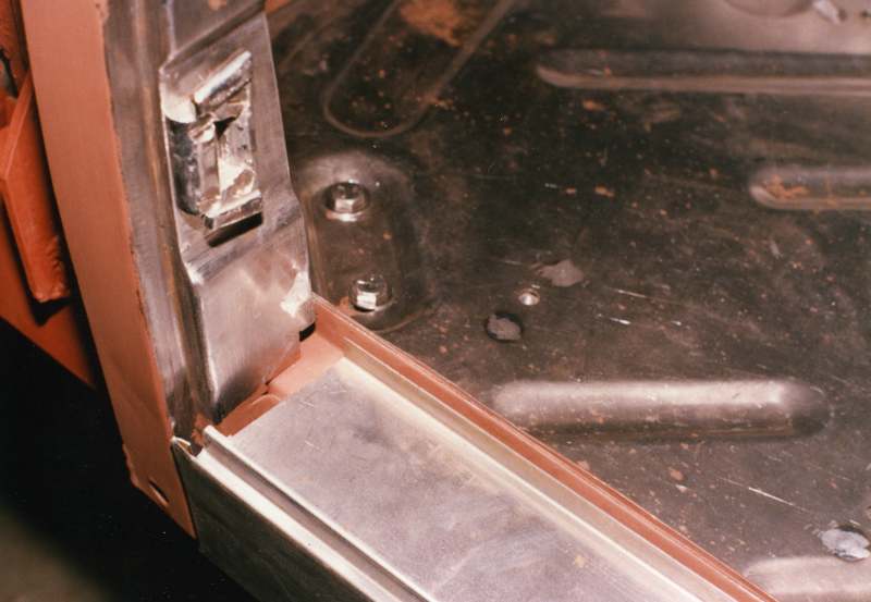

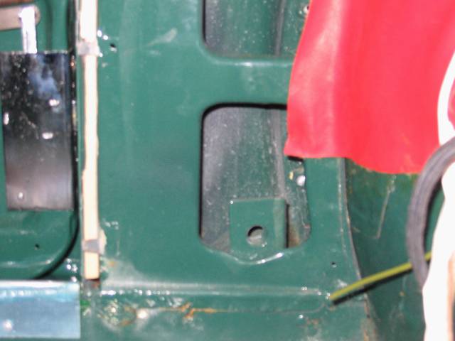

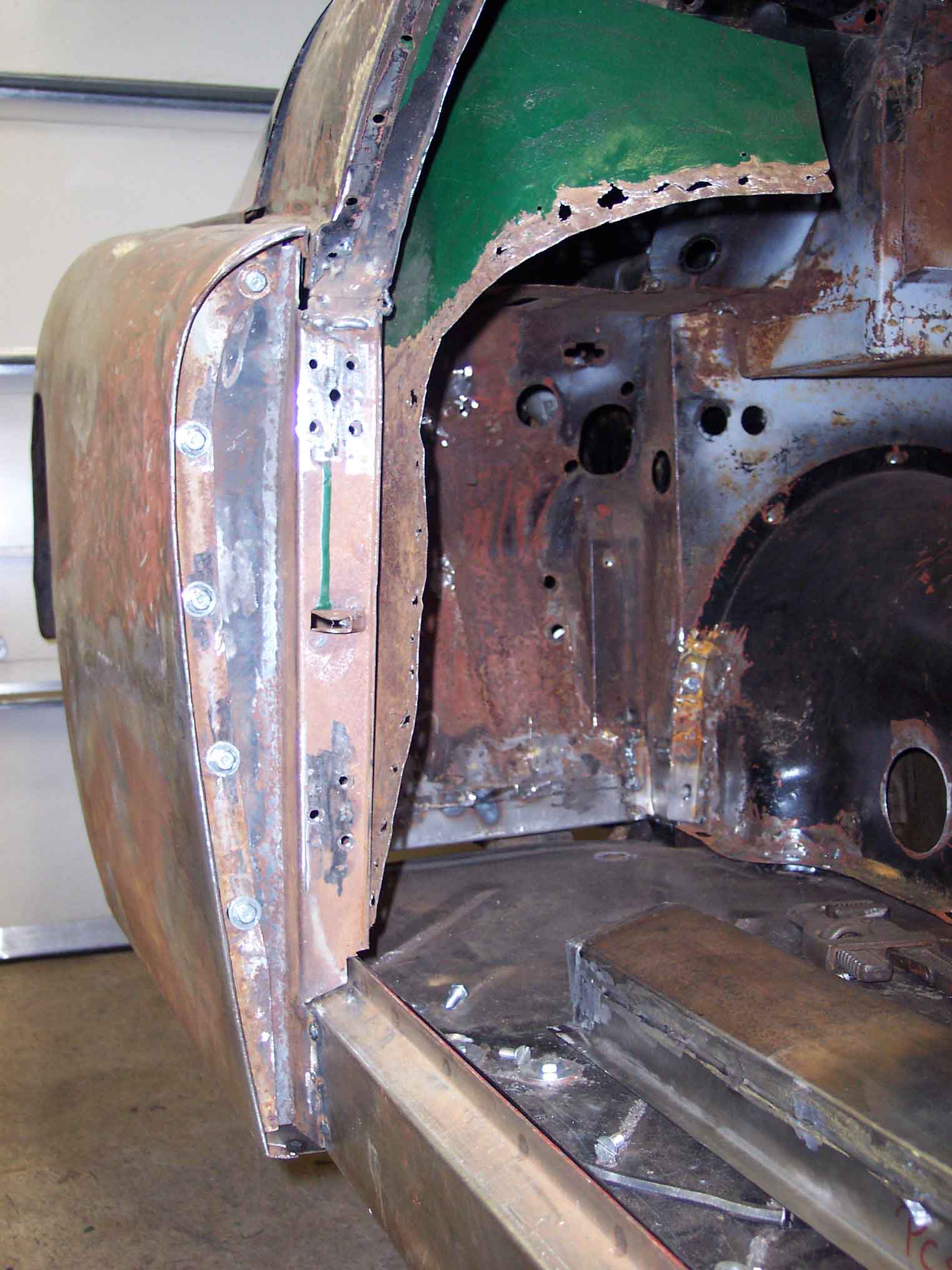

Here are some from my own TR3A restoration in 1988. It took me a while to find them and re-size them. The new outer sill was too short at the "B" post so I had to MIG weld in a small piece. The front curve (see screwdriver) to clear the door when fully open was too small so I had to modify this where it's welded to the "A" post. I also had to take a large rubber mallett to the insides of the outer sills to give them the curve they should have to follow the curve along the door. The outer quarter panels are different in that one side is for the early TRs while the other side is for the later TR3As and TR3Bs where we can see the joint.

Don, thank you for the pictures. They are really going to help. I like the bracket for the seatbelt and may copy that. I have a couple questions:
It appears that the quarter panel must come off to replace the inner sill from what I can tell from the pictures. Am I correct in that or not?
Did you use lead to finish the joints at the A and B posts?
As an aside, The B post end of my outer rockers have a 90 degree bend up about 1/2 inch tall as a tab to weld to the post. I did not see that on yours and wonder if I got some odd ball piece.
Thanks again, Gordo
Re: TR3A "B" post
My quarter panels were so rotten, I had to change them. I suppose you can change the outer sill without removing the quarter panels. If yours are rust-free, give it a try.

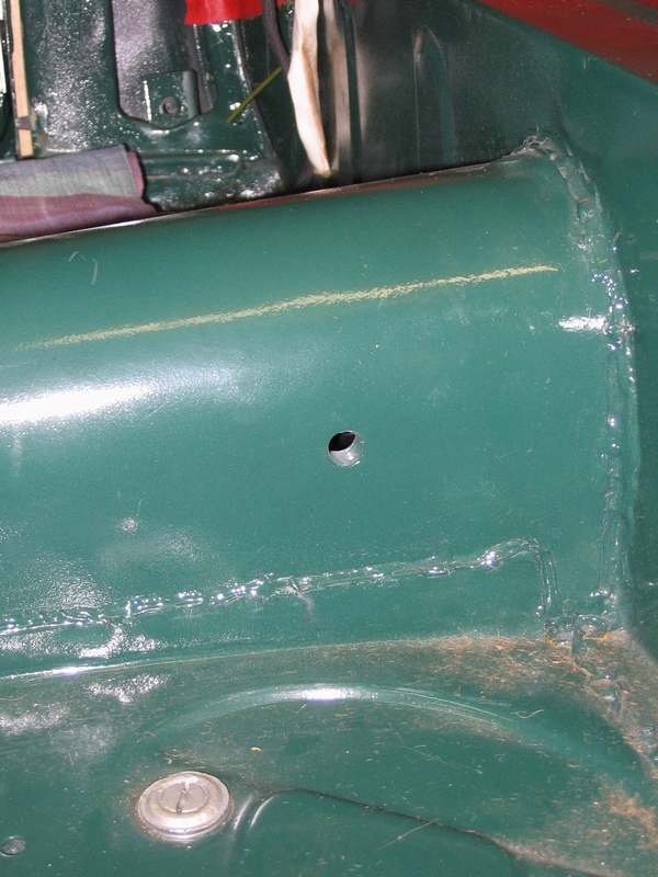

I also have 2 nuts welded to a plate inside the driveshaft tunnel for the inner ends of the seatbelts. All these photos are from the late TR3A I finished in 2006.
There is no lead. The finihishing and painting was done by the body shop and for both TR3As, they used a tiny bit of body putty at the rear end, next to the "B" post. There is none at the front end as it gets covered by the front fender. y joints are still good after 97,000 miles.

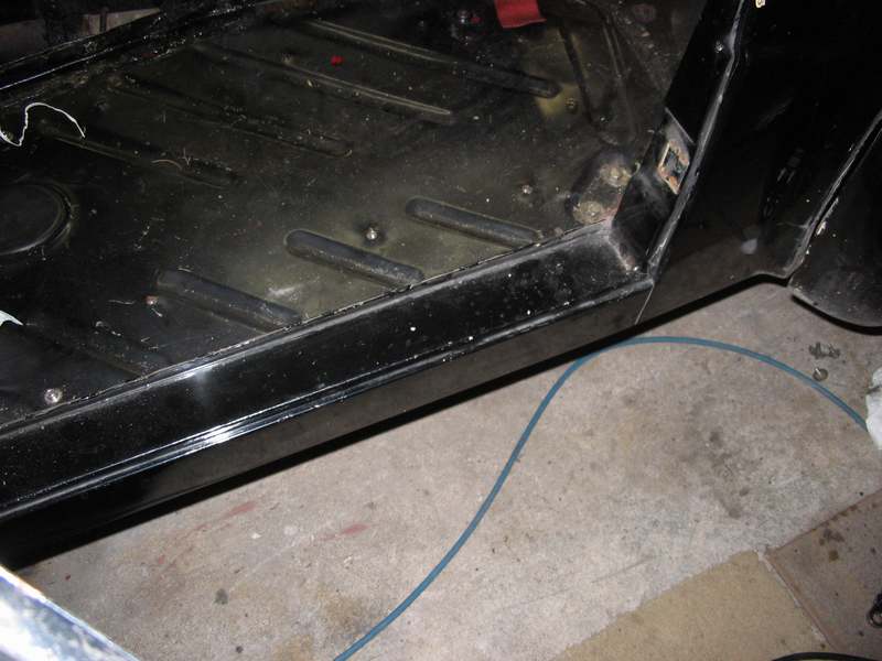

My sills did not turn up. In fact I had to MIG weld in about 5/8" extra along the top flat portion. I did them all like they were originally. They are flat to the "B" post and I MIG welded the sill top to the side of the "B" post with a nice fillet of weld. Then I used my die grinder to really smooth out this radius. Looks terrific.

Re: TR3A "B" post
Don, that new set of pictures is just awesome. I'd like to compliment on your work.
I spent the morning killing a pot of coffee and just looking at the B post on my car. I've come to the conclusion that I may be able to cut the quarter panel off about 7 inches up from the bottom to access the inner sill. My quarters are rust free and I really hate to cut them but I see no other option except for splicing the new and old inner sills just in front of the rear body mount.
