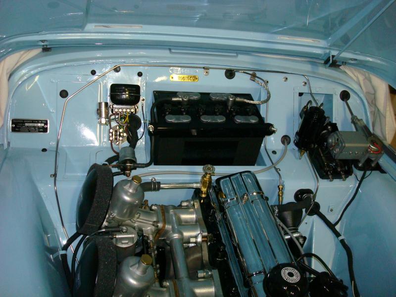

For the TR3A I made some Koozies using sheets of foam cut into lengths and glued into circles:
The foam was packing in a Harry & David fruit box though any fairly open foam should do. I find that I get the same idle with or without the foam on there so I believe it is not an excessive air flow restriction.
For the TR4 I sliced up a Shop-Vac filter - that produces nice rings with no gluing.
In any case, they should restrict some dust and can be easily pulled off for shows.

I just ordered the ShopVac sponge covers ($5 on Amazon) for my gravel catchers and will advise once they arrive and I have them installed.
Pat
Pat, is your intention to use the foam instead of oiling the gravel catchers? Or are they for added dust filtering? Seems like would not need to oil them with the foam filters, and end up with better air flow.

My plan was to just pull the foam filters over the gravel catcher and run. The foam would be dry and would filter air for the engine. I don't think I'd oil the gravel catcher any more (at least not with any frequency) if I'm running foam cozies on my stock filters. The ShopVac filters aren't made to be oiled, so I'll surely run them dry. Photos and an assessment to follow.
pat
