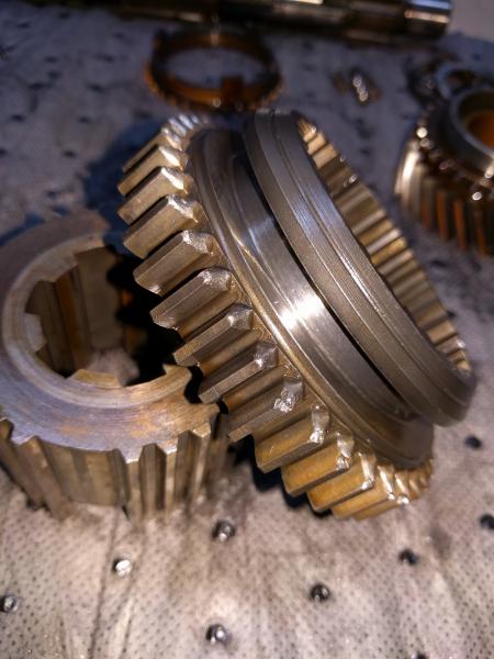

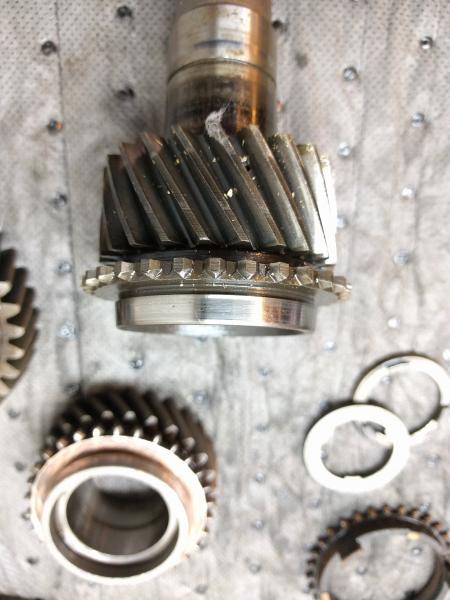

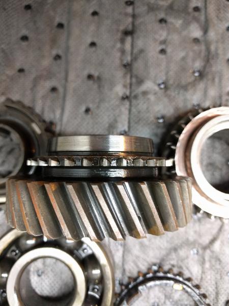

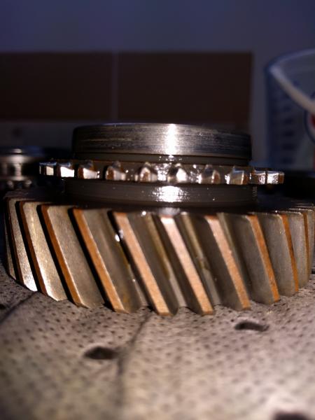

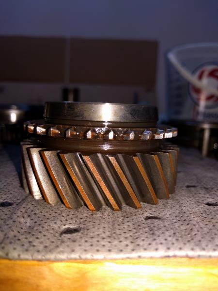

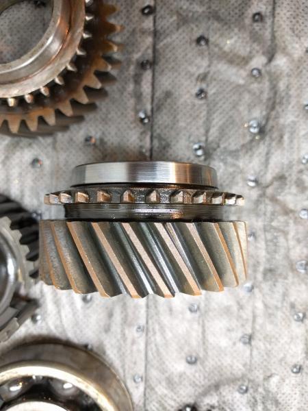

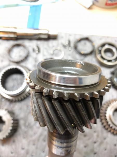

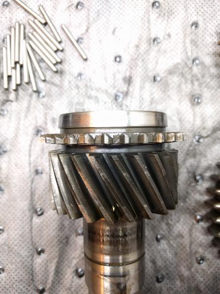

I can understand making all the teeth asymmetrical to improve fast upshifts at the track. I have trouble understanding only making 2/3 of the teeth asymmetrical though. Maybe the engineers figured 2/3 of the shifts are up, with only 1/3 down?? Maybe Triumph wanted to emulate the German idea, but were non-commital?? If it improves upshifts, then why not make ALL the input shaft dog teeth on the input shaft asymmetrical, since they only see upshifts??
Boggles me.

Based upon my understanding of the above, I would guess they used 22 asymmetric teeth to increase the load capacity for the gears during drive, but kept 8 teeth symmetric to maintain an acceptable level of performance during coast. If that's the case I think the asymmetrics are a better gear, but also probably more expensive to manufacture (which may be why they switched to symmetric gears at a later date).
