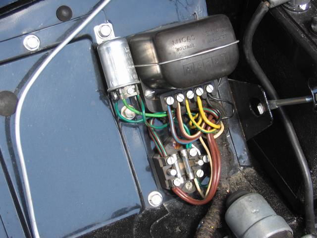

You are fine as long as you have an early harness without the spade connectors. That is a lot easier to trim shorter if necessary. It is always handy to have a harness that is a little long. That way you won't be stretching wires through the bulkhead which could cause chafing in the future. Also if you ever need to take a switch or gauge out in the future you will be pleased of the extra wire.
Here is how it looks on my 1958 TR3A. Those are the original wires from 1958 so there was no need to shorten them. All I ever did was clean them in 1990 during my restoration but in 2007, I sent it off the Rhode Island Wiring and had a new black cotton loom wrapped on the whole harness. The photo is from about 2005 before the new loom was put on.
