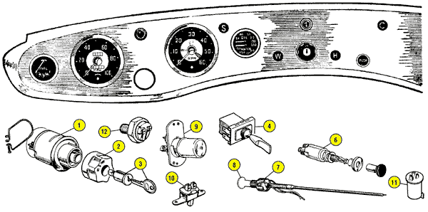

Well, you could use an early Sprite switch. They were panel mounts.
#4 in this picture.
Jeff
