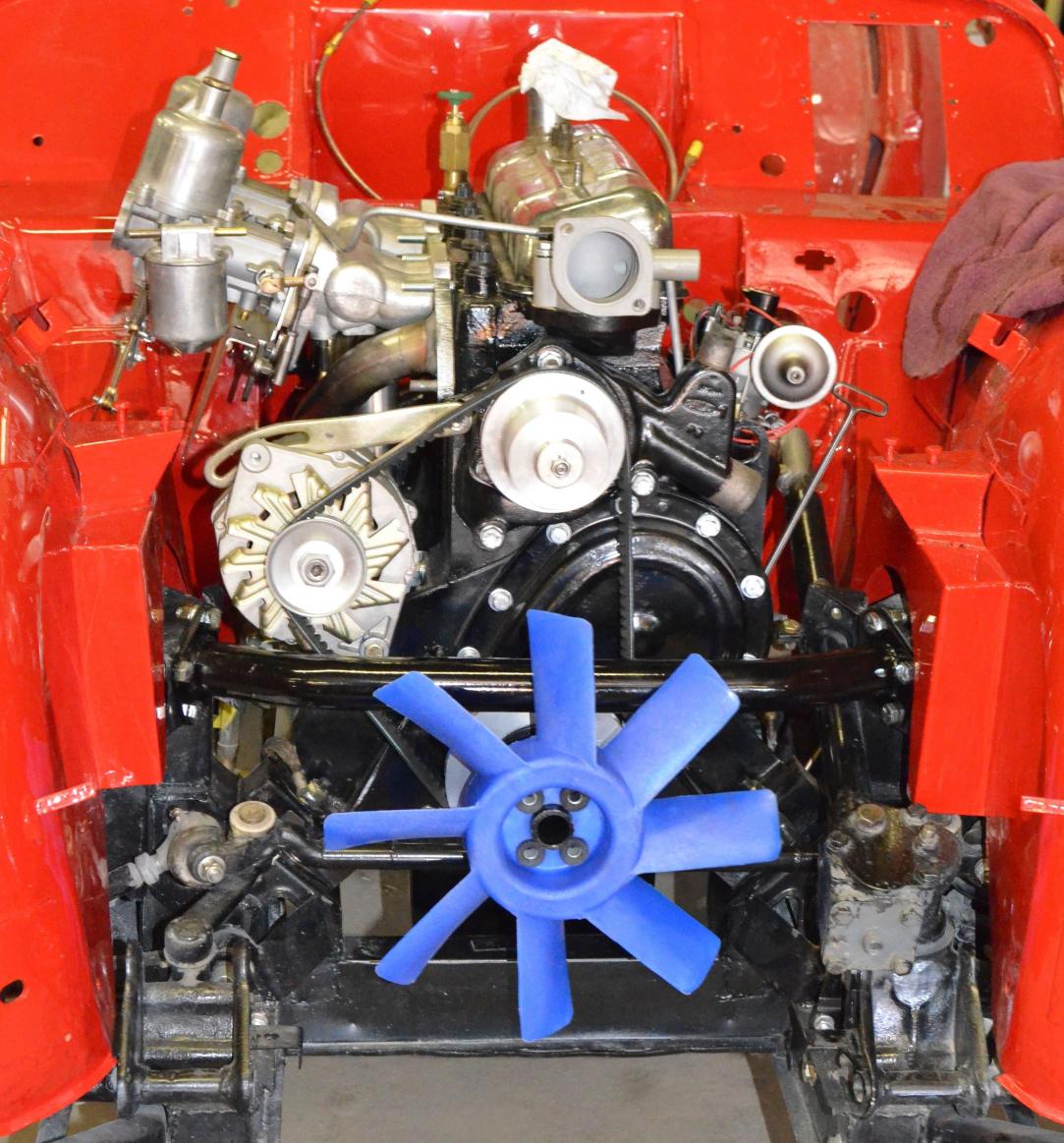

I used the TR6 fan. Too bad it's blue. Red wasn't available at the time.
Other cooling upgrades include narrow pulleys, 6 blade pump plus radiator air deflector.

PN 211986 seems to have been introduced some time after 1960, and was the stock fan (or at least listed as an option) on several Triumph models including TR4A, early Vitesse/Sports 6, Triumph 2000 and early GT6.

croz, have you installed your radiator yet and did the fan clear the radiator? When I tried to put a yellow TR250 fan (same as TR6 fan) on my TR3A the right way around, it was against the radiator, so I turned it backward. It does not push nearly as much air when installed backward.

I wondered that too. When I fit a TR6 fan to the TR4 I had to flip it around and use a spacer (made from an old cutting board). Well I thought it was old -- certainly couldn't be used as a cutting board when I finished with it.

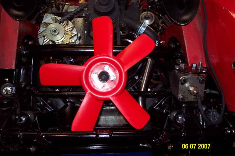

Yes, that is a TR6 fan, painted black. Ditched it when I found a tropical-style fan.
I also have a reversed TR6 fan on my TR3, and painted it black. It is slowly returning to yellow, and flakes of black paint are found inside the engine compartment everywhere. If I'd have known I was going to paint the car yellow, I never would have bothered trying to make the fan black.
