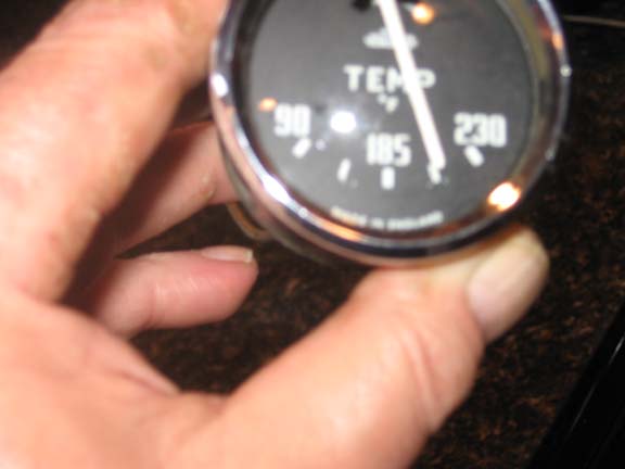

This was the site that I used to repair my cappillary temp gauge. I used the gauge that was in the car as a donor. It was a Stewart-Warner 270 deg gauge. I see these gauges at Pep Boys for less then twenty dollars. The procedure is is pretty straight forward. When I got done and tested the gauge in boiling water, it measured exactly 212 deg F. It's really incredible how low the temperature goes in that ice, salt slurry. IIRC measured it at about 10-20 deg BELOW zero. Cold enough to keep the ether in the bulb.
Sorry for the out of focus pic. When I shot that, I forgot to put it on macro.

TR3driver said:
Tho I've not tried it (yet), it should be possible to check out the head with air pressure.
That is indeed true and I played with this a bit prior to rebuilding the first gauge I worked on. However, that was not really the problem... the pressure gauge portion performed "normally" but something appeared to have "messed up" the gauge calibration prior to the capillary tube failure.
On the first gauge I worked on, the temp needle was NOT sitting on zero when the capillary tube was cut off. I didn't think a thing about this when I started the repair but I found that I had to spend a LOT of time calibrating the gauge to get it to read correctly. I'm not sure what happens to the gauges to cause this, but I've seen this on several dual (water/oil) gauges.
On the next dual gauge I worked on, the temp needle was on the left stop when I started the repairs and it worked very well and calibrated easily.
Again I don't know what causes the gauge to fail with the needle off the low end of the scale. However, from now on I won't bother working on a temperature gauge unless the needle is at the zero peg when the tube is cut off. I'll leave those repairs to the pros.
