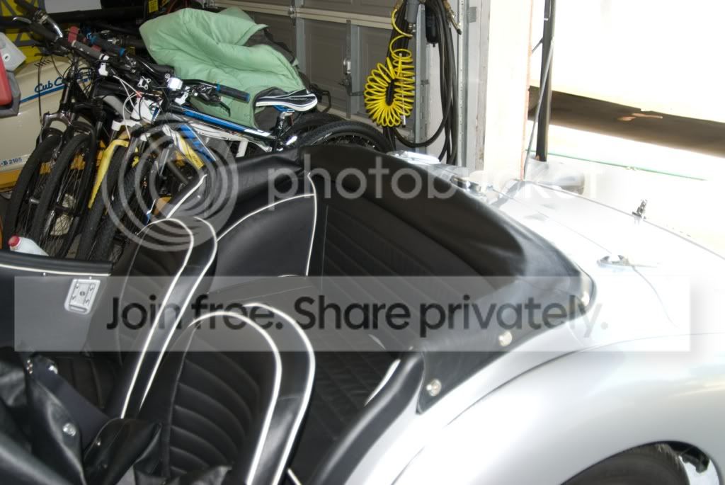

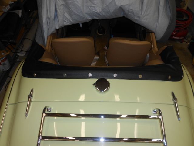

Here ya go
#1

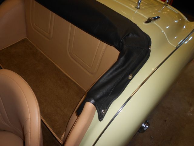

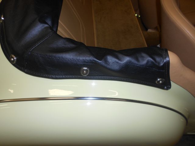

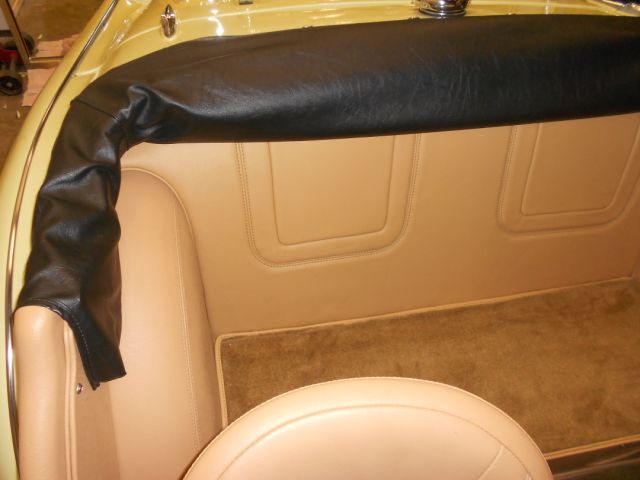

Here's a tricky bit... there is a hidden LTD fastener that is upside down and goes on a peg on the inside of the capping:
Ends up like this:

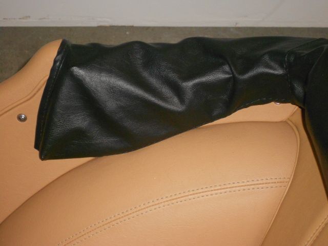

In case you can't tell in the other photos, the forward point of the folded sticks go into a pocket at the front of the cover. This is important I think as it keep everything in place and not trying to fly in the breeze.

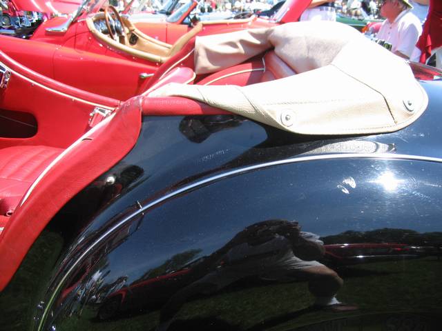

As fitted:

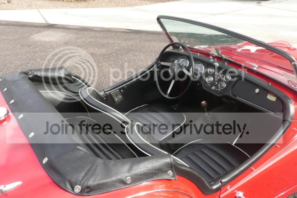

See the original hood stick cover that came with my 1958 TR3A almost 54 years ago. This is a recent photo and it still looks like new.

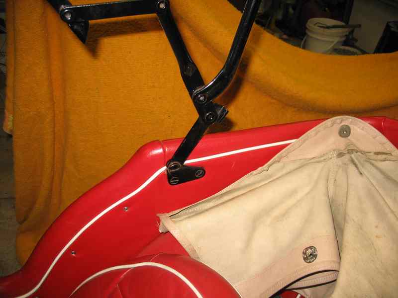

At one point during the life of the TR3A, S-T changed the peg to a higher position at the top of the dog-leg. Here is mine from my "early" 1958 TR3A (TS 27489 LO).
