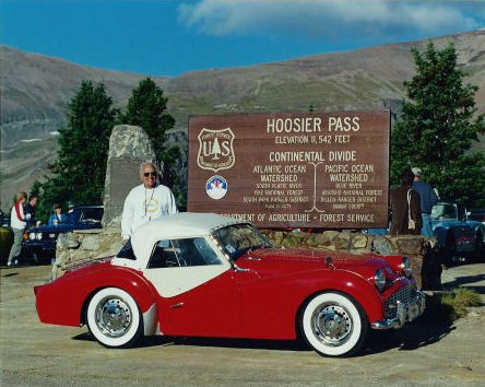

And if you want, I believe there are shops that can add stripes to the black side. You could have "redlines", or skinny whitewalls, or even wide whites; all for a price of course.

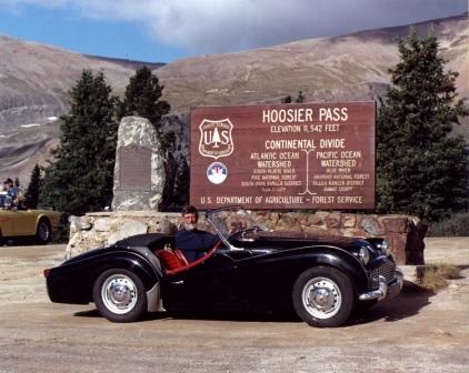

That is Fred Thomas, who passed away recently. But I posted the photo just because it shows off his "wide whites". I always thought they looked kind of stupid, until I saw them on Fred's car.
A beautifully restored car, and Fred drove it, too. That photo was taken near the 2001 VTR convention in Breckenridge, CO. Fred drove there, almost 2000 miles from his home in VA. I don't know if he won any awards (I skipped the awards banquet), but he should have.

Randall - I remember that day we all drove up to Hoosier Pass in 2001. It was mid-August, early in the day, and when we got up there - there was snow on the roadsides from the snowfall the night before. I drove 2534 miles there and a lady from NJ drove her's 2535 miles there. Talk about close, till a guy from Tennesee arrived in his TR8 having driven to see friends in San Francisco and San Diego before arriving at VTR in Colorado. He did something like 4300 miles to get there.
My total trip was 5225 miles return with no convoy, no cell phone and no CB.
These cars are made to be driven. That's the year I was awarded the Ken Richardson Cup.
