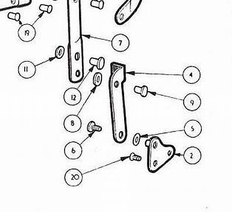

I have 1960 TR3 with a hard top. I would like to put the soft top on. I have the top bracket and the soft top, but not the hardware to apply to the car. What bolts are required to attach the roof bracket to the vehicle? Also, the roof bracket have strips of cloth that control the opening distance. My strips are torn. What are the length of the strips so I can replace them. Thanks, Jim
Assuming you are talking about item 20 in the diagram below, those are 1/4-28 flat head bolts, 3/4" long with pointed tips. The pointed tips aren't absolutely necessary, but do make it easier to get them started into the nut plate inside the body shell.

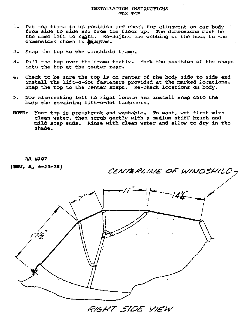

On the webbing, there is enough variation from car to car and top to top that it might be a good idea to trial fit your top and choose the lengths that make it fit best. However, here is an old diagram (supplied by Geo Hahn).
You can get a roll of the strip material from the usual suspects. The roll is longer than is needed. I install the strips to the front hood stick and leave the strips long with the excess at the back. Then, after I adjust the length between each hood stick so that they align with the seams on the hood, I cut the excess off.
Total length of webbing strip each side is 36" plus a double fold where it attaches to the back of the cockpit.
On mine, first section is 18.25" to the rear bow, then 6" to the next, then 11.75" to the front bow.
Each car may be slightly different, depending on who made the soft top.
It's best to fit the first section of webbing to the rearmost bow, then fit the soft top to check the web spacing for the next two bows.
Hoodbows to body fixing screws are 4 off 1/4" UNF thread x 3/4" long with countersunk head and a plain screwdriver slot.
