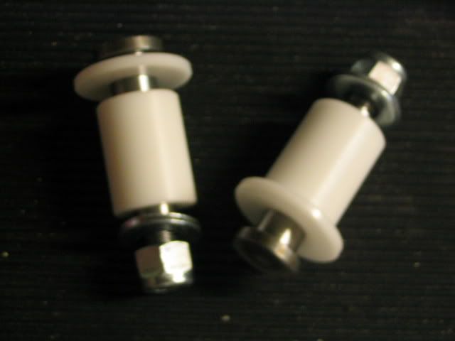

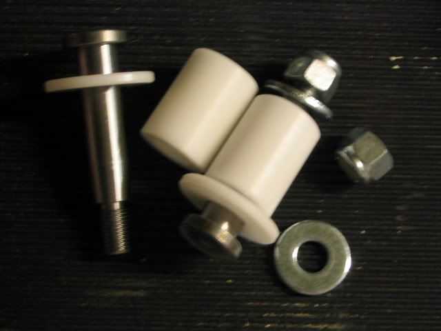

I recall some talk about Derlin versions of these silent blocks, but I can't seem to find any. Has anyone used them, what was the result and where can I buy them?
