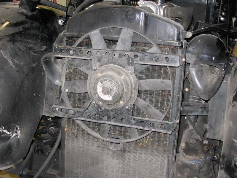

I had a leak in my rad in 1972 (80250 miles) when I pushed my 1958 TR3A over in the corner of my garage. During the restoration from 1987 to 1990, I had a new 5-tube core unstalled with the hole for the crank. The rad shop soldered the core into the original frame and headers. Since then, with a pusher electric fan (which I only need to use in traffic), I have driven another 104,000 miles with no real issues.
