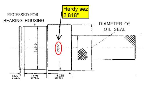

If you are talking about the aluminum scroll seal, you pretty much need to pull the engine. The flywheel has to be removed to get at the bolts for the upper half, and the crankshaft has to be removed so you can lay in the mandrel to center the seal (it's supposed to almost, but not quite, touch the crank scroll). BTW, the mandrel dimensions given in the shop manual (and supplied by some vendors) are WRONG.
