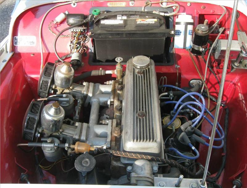

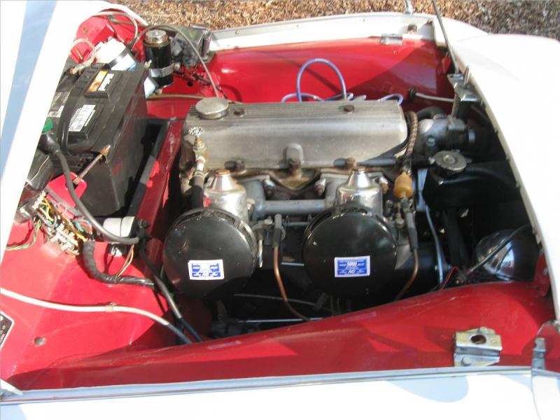

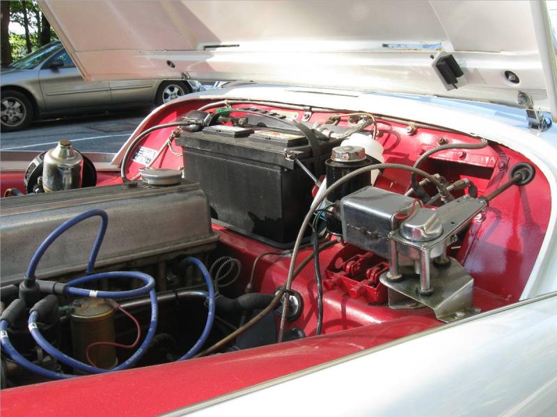

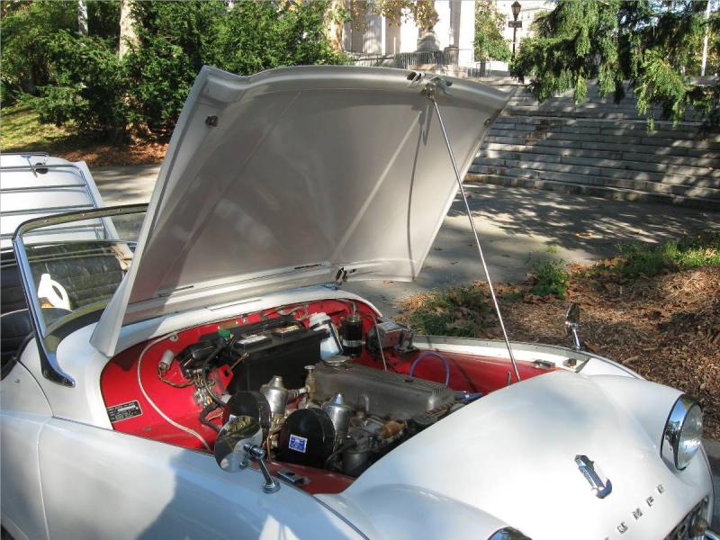

Here's my engine well:
Sorry for being so proud...

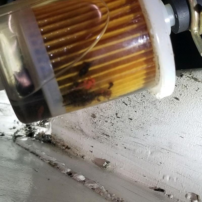

Very neat and tidy. Do you have a fuel filter before the fuel pump as well?
I am amazed what it can collect. I thought my tank was clean and rust free.
David
