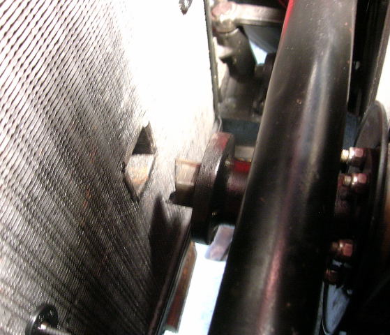

Here is a picture of how much room I had to work with. Not too bad, I did all work from under the car.
Note the 2x4 under radiator.
The crank hole now is on center of the bolts.
Thanks Triumph for the duel purpose crank hole!
Waiting for parts.
Lyle

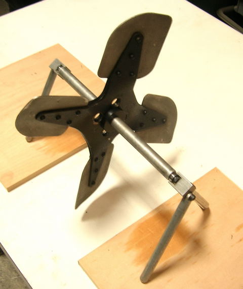

About balancing, I was looking at the fan and thought about just balancing the fan. The hub is small diameter (not much rotating mass) and should be pretty concentric.
I pulled out my Go-Kart wheel/TR3 fan balancer.
Made up a bushing to fit the fan hub out of delrin.
The fan is out of balance for sure.
Lyle
