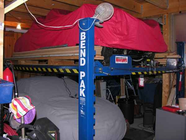

Good point. I find my lift indespensible for nearly everything from oil changes, exhaust work to suspension, and of course storage. My 4-post Bend-Pak US made lift was around $2000 including 2 jack plates, delivery to the nearest freight terminal. It was a 1500lb bundle and the terminal let me unband it at the terminal and carry each part to my trailer. The ramps were close to 300lb each so I had to call for help to move those. Everything else, I did myself.
I am able to store two cars on the lift during the winter months in a 9-1/2' ceiling. I just added a 14x24 addition to my shop so it's a little bit busy out there right now. The lift is in the original 24x24 workshop barn (that we built ourselves), and beside driver's side is an 8 foot opening to the new addition. My TR4A is sitting there awaiting completion.
This place https://www.asedeals.com/lifts2.html had the best price and excellent service. Also purchased my AC Hydraulic low profile jacks https://www.asedeals.com/hydraulicjacks2.html from them. nfi
