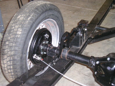

Yep, here is a shot of mine and I used new springs. As you can see it sits right on the frame thats why hopefully you added new rubber bumpers. E-mail me if you need anyother pictures.
Cheers, Tinkerman

Re: TR3- installing rear leaf springs = nightmare
Cheers, Tinkerman
Thanks for the reply. Did you also have to force the spring eye down to install the shackle?
On a parts car I had but all original the axle was maybe 1inch above the frame.... maybe its just the new springs that are making it sit right on the frame. It really does seem like something is not right to have the axle sitting on the frame.
Without the weight of the body, it's normal for the axle to touch the frame. With the body on (and of course the car's weight on the wheels), there should be some space, but not a great deal. If memory serves, it's only about 2" with the car fully loaded (full tank of gas, spare tire in place, two people in car, etc.)
But there have apparently been some springs on the market that weren't arched correctly, so it might be that you do have a problem.
Even with old original springs, the released spring doesn't touch the axle. I had to jack the spring up a bit to get the nuts started.
