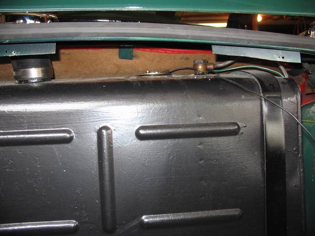

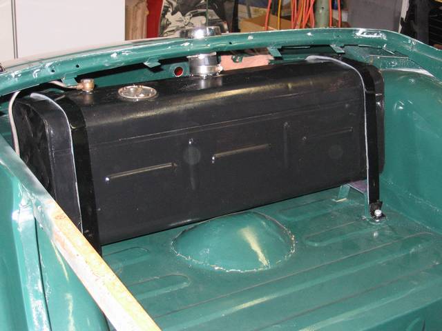

Those photos are of the tank were taken on the late (TS 81551 L) green TR3A we finished for Frank in Toronto (near 401 and 400) in 2006. The fuel fitting on the bottom of that tank for the fuel line to the fuel pump comes out the bottom of the tank off-center. You can see the hole close to the rear arch on the LHS closest to the camera.
On my own very early 1958 black/red TR3A (TS 27489 LO), the fitting comes out the bottom in the center of the tank.

so its confirmed, I have a early tank.... I would have never thought they had different tanks for TR3's.
