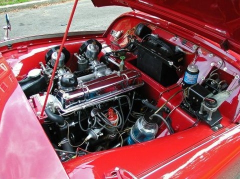

Aloha Tom,
Here is a photo I found on line of the engine with a heater pipe installed. The end of the pipe at the rear of the engine should be pointing toward the fender. A short hose with a 90 degree bend leads to the through firewall fitting. In the photo the top of the coil is red and you can see the pipe behind it about even with the top of the block.
