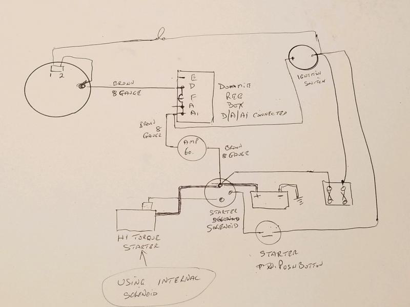

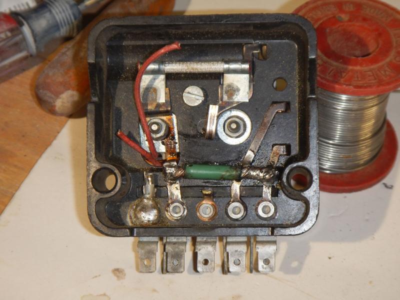

This is a sketch of my wiring diagram. 60 Amp Alternator Negative ground. I have used the Regulator box as a connection point by gutting it and linking D, A and A1
Ignition and direction lights are regular bulbs. Thanks for the sketch. I, too, gutted the regulator box and used as connection point.

David, Your sketch jogged my feeble 80 year old cognitive memory.I have installed a DynoAlt and was planning on purchasing one of their Dummy Regulators.As I recall, if you continue using your old regulator, after making the wiring changes, you should gut the insides?Is this correct? I forgot to do that. Could that be a reason I am melting the white wire?

I installed the "Dummy Regulator" and rewired everything according to the instructions. All the lights work now, including the ignition. Engine turns over fine with starter button.

Sorry Dick I must have missed your posts about the regulator box mods when you use it as an Alternator junction box.
I believe this is a Randall mod.
David

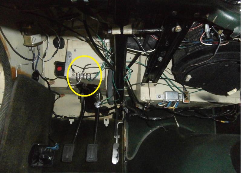

I added a buss bar so I wouldn't have to find places for accessories, etc.My BussBar .jpg
The left two sourced from A2, the right two from A3 (always hot)

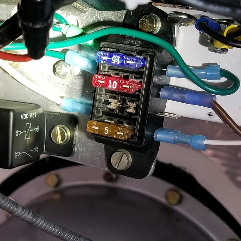

I have the wire that is shown as going to A2 wired to a relay. The relay is powered on by the ignition switch so if I forget to turn the heater off I do not come back to a dead battery. The relay is use to supply power to the heater and a few other things when the ignition is on. They are all fuse with modern fuses.
David
