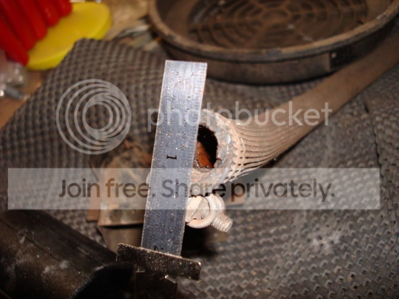

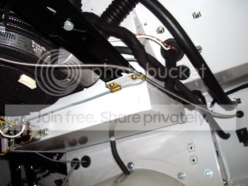

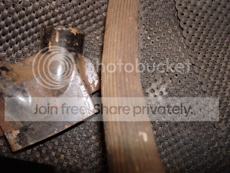

Art: Fortunately I take photos of everything. Here are shots of my original hoses and wire-type clips, and the replacement ribbed hoses from TRF.
My experience (long ago, when I lived up north) was that the smooth replacement hoses had a tendency to kink above the heater and impede water flow.
