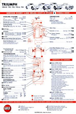

Mornin Gil, I have a Texaco service chart that shows 24 grease points, plus a bunch of other service info. If you pm me with your address I will get it copied at staples (it's a weird size) and send the copy to you.
Cheers, Tinkerman
Yep, Andy same one.
Dick

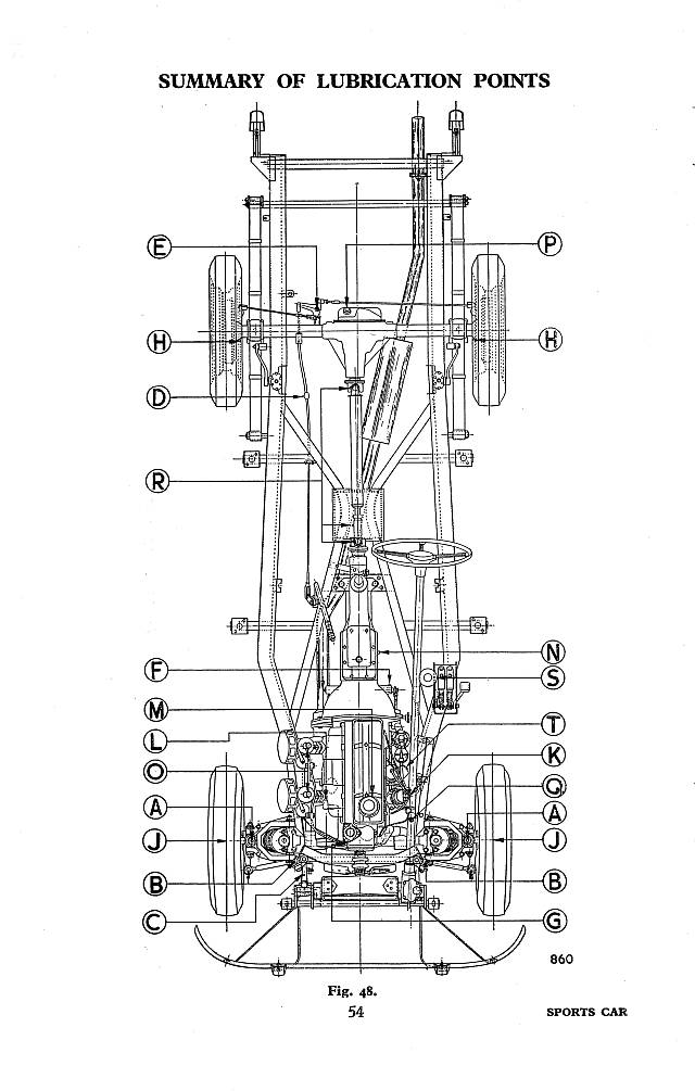

It's hard to see on the above drwg, but F is arrowed to two grease points - one either side of the clutch shaft, making up the correct total of 24.
Viv.
