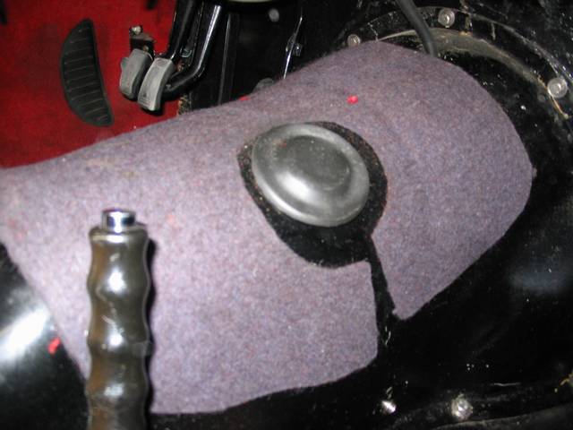

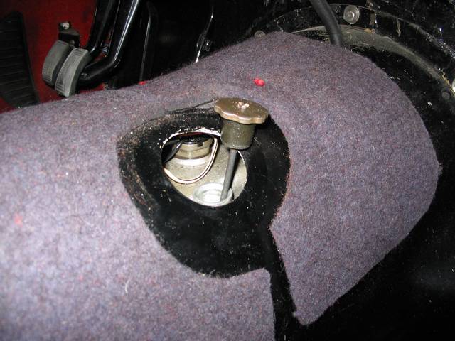

To see the oil level on the dip-stick in my early 1958 TR3A with 4-speed + overdrive, I have the filler hole and dip-stick on the right side of the gearbox tunnel. I remove the carpet, then the rubber bung plug and then I pull up the dip-stick.
To make it easier to read the oil level, I drilled two tiny holes in the dipstick about 30 years ago. These are about 1/32" diameter and I chamfered the corners off a bit. When I pull the dip-stick out, I can see the oil held by capillary action in the lower hole. If there is oil in the top cross-drilled hole as well, then I know the oil level is up to there. It's a bit like the oil you see in the "V" notch of the dip-stick but easier to see.

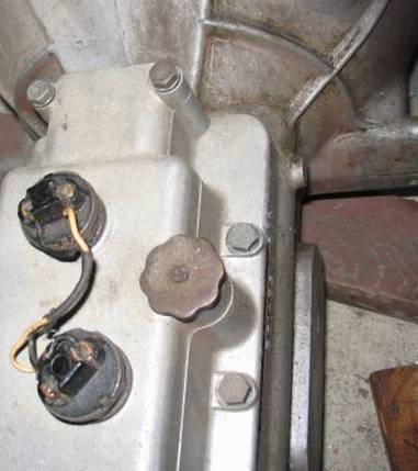

Sorry for the delay, somehow I missed seeing your reply. So, does your felt hold the dipstick up at all? Or does the metal top on the dipstick still rest directly against the top cover.
PS Glad to hear all is well with you.
The bottom of the "flower edged" top plate of the dipstick fits right down in the hole - metal on metal.
