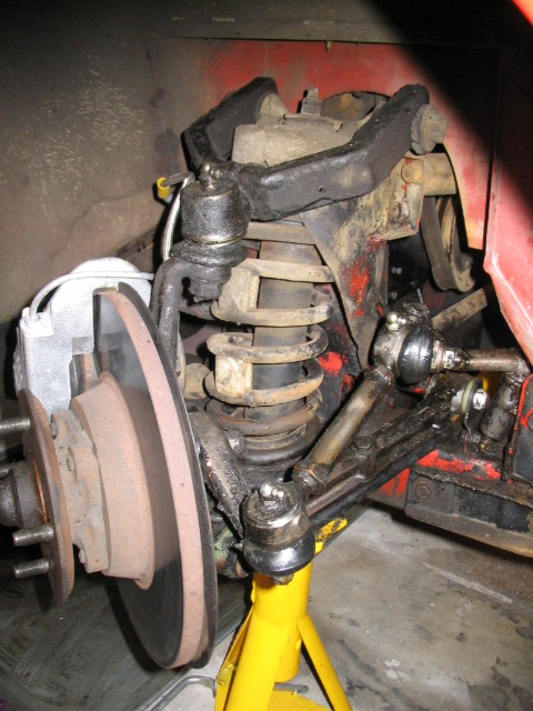

Hello, Listers, now that my car has good brakes, it's a little floaty at speeds above 60+. Shock replacement is due. Anything to know before I dive in this weekend? I've looked in the manual, and it seems pretty straightforward, but not as easy as on my '55 Bel Air, back in high school. Any BTDTs appreciated.
BTW, what's the purpose of these doodads in the spring? I know they're not original...

Those doodads are spring rubbers and they are used to stiffen up the spring rate. They will also increase the ride height a bit when in place.
Are all your bushings and trunions in good shape? A fresh set of bushings will may the front end feel much better at speed. If you are going to be dropping the spring pan it is not all that much more work to change out the bushings.

Dick is right, those doodads are stuck in there to either stiffen up the front suspension or perhaps to compensate for some sag in the old springs. TR springs are not prone to sagging, though, so it's possible someone installed them to accommodate larger diameter tires or as a cheap alternative to a front sway bar. Replacement springs are not terribly expensive, if needed. There are basically two different lengths, depending upon whether or not the 1-1/4" thick aluminum spacers are being used with them. Either will work... just leave out the spacers if using the approx. 11" long coils and leave em in if using the 9.5-10" long coils. There are also stiffer, competition grade springs available in both lengths. At the top and bottom of each spring are rubber pads that prevent metal-to-metal contact. If the aluminum spacers are used, a total of six rubber pads are needed per car (three per side). If not using the aluminum spacers, only four rubber pads total are used.
