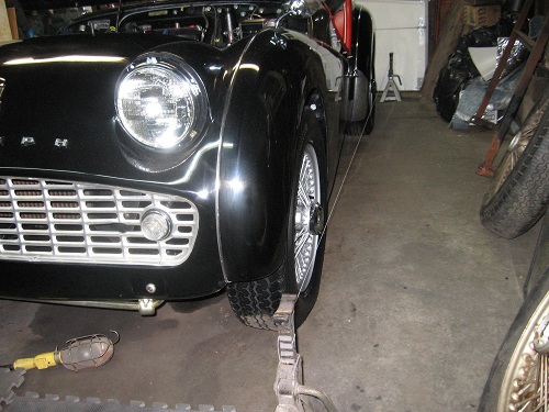

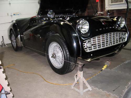

I used the "string" method for setting toe. Basically, you set the strings outside the car parallel to the center line of the car. Then you just measure to the front and rear of each front tire to get the toe-in. It'll work for the rear also if you have IRS. Of course, you have to be very careful you don't trip over the strings or you have to reset them, and that takes about a half an hour! :laugh: Camber on a TR3 isn't adjustable without modifications, but I did measure it using one of these.
Edit: I set the toe-in at 1/32" and the camber came out to be 0° on the left side and between 0° to -1° on the right. At least it wasn't positive. :laugh:

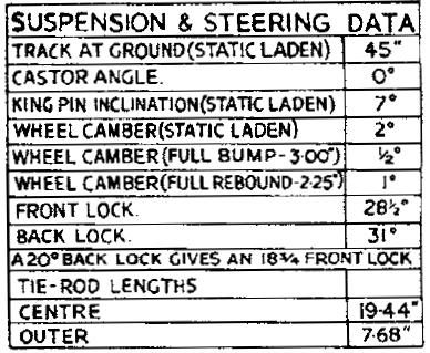

Huh? The spec is 2 degrees positive. I can see not worrying about it not being quite right, but why are you happy about it?

From what I've read, modern tires seem to work better with a bit of negative camber. When people modify the early TR upper A arms, they are doing it with the express intention to allow for some negative camber. Seems like a lot of work if there is no benefit to be gained. I'm not going out on the racetrack, so it really doesn't matter to me, but why shouldn't I be happy if, for whatever reason, the camber is heading in the right direction. The car as it's set up now handles very well and I'm quite happy with it. I wish it had some caster however. One of these days I'll put in the 3° TR4 trunnions and upper A arms.
The positive camber in the TR is to reduce steering effort. It places the tire contact patch closer to the wheel pivot axis. Untill you go to wide tires (I mean much wider than what the TR can take) a couple degrees either way is not likely to be very noticeable performance wise.
John
