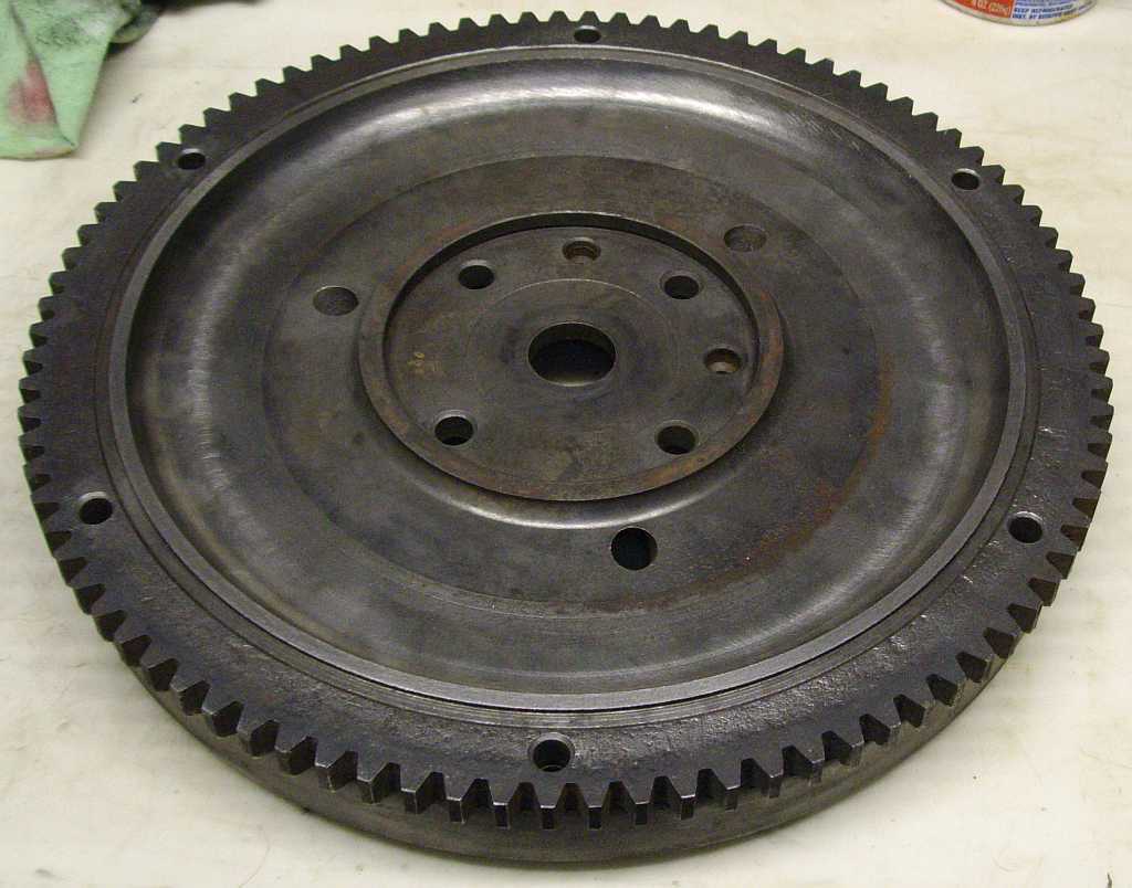

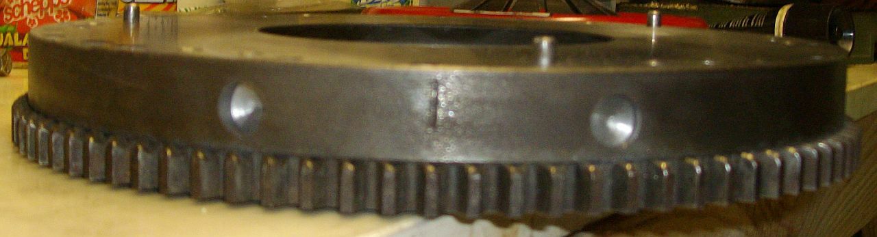

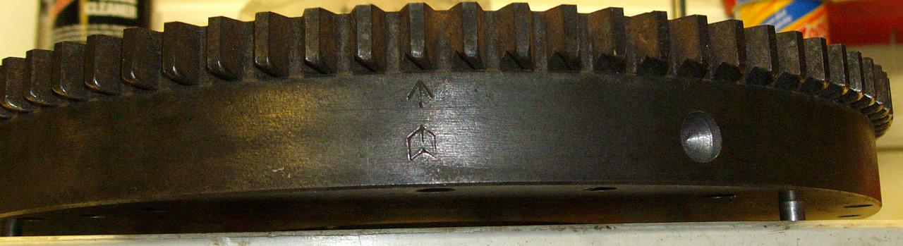

Unlike other animal markings, the ones on my flywheel are stamped. One looks like an I and, 180 degrees across, is another that looks like an arrow. Which is supposed to be TDC?
Two more X's were just added when the machine shop balanced the pressure plate with it to indicate where the matching X on the pressure plate lines up during assembly. They removed about 5 lbs. It now weighs 14.5 lbs. They also redrilled and taped it for the TR6 pressure plate.
The party continues.

-Oh never mind. I see the dowell in the crank will allow the flywheel to fit only one way, so the arrow will be up at TDC, and the I down.
