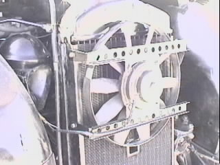

I always overheated. In 1987 to 1990, I restored my TR3A. It still overheated despite installing the air deflectors that surround the radiator. When I bought my car brand new in May 1958 it didn't have the air deflectors. They only started to put them in a few months after mine was built. So in 1991, I had a new core put in the radiator. Now it would only overheat when I was stopped in traffic for about 3 to 5 minutes.
So I put in a 12" diameter Kenlow fan which I bought during a business trip to England. I like to keep my car as original looking as possible so I installed it as a "pusher". It's in front of the radiator. See attachment. I made the brackets you see in the attachment because I thought that the long screws right supplied with the fan that mount it through the fins of the rad were a "Mickey Mouse" design.
I never installed the thermostat. I have a switch hidden under the dash which is connected through a relay to the fan. I manually flip the fan on when I'm stopped in traffic and I watch the temp gauge. When I'm back up to speed, I turn off the fan. On 2 or 3 ocasions, I forgot to turn it off when I parked the car and I can hear the fan whirring. This reminded me to turn it off.
