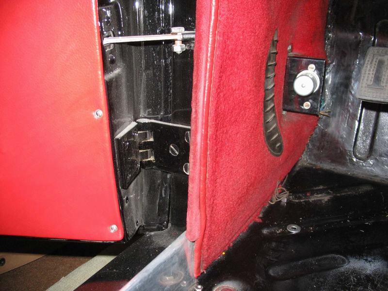

Not sure if bolt pattern changed later, but here are my originals from by 56 for comparison to what you need. Cheers, Mike

Yep. Mine is actually broken. Thought I could weld it but the pin won't even come out. Appears the pin froze and at some point it broke the upper ear on the hinge. It appears the bolt pattern is the same,based on the picture, so I can use the old style as a replacement. Actually the old style looks more sturdy than the "new-improved" later ones. If anyone has one of either-late or early-let me know, I'm interested in buying. It also appears the Rt and Lf are interchangable. Catalog shows only one upr and one lower. Thanks for all the input.

I have hinges on my "early" TR3A (TS 27489 LO) with brass hinges as you show above. The 4 plus 4 hinges are at the top of the door and the top of the "A" posts. The hinge with the 3 holes is the lower hinge.
