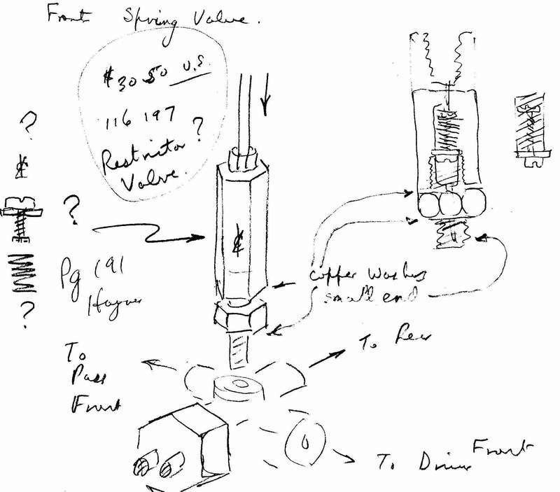

Always make a diagram if dismantling the restrictor, so it goes back together correctly. Don Elliott has posted an excellent drawing he made of the internals for re-assembly.

Here's mine. Haynes Manual also shows it.
