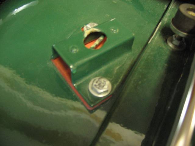

Maple Leaf - There are pads made of fiber (box-car red/orange in colour) that you have to use as shims under the Dzus bases for securing the bonnet. I have seen up to 6 such fiber pads to get the right height and the right twist needed to lock down the front so it's at the right height.
George - If your hood (bonnet) is scraping along the trim that goes along the top of the wings (front fenders), may I suggest that you loosen the 7/16" across-flats bolts that hold the fenders to the inner wings (fenders) and move these fenders out a bit to get equal clearance on each side so nothing rubs.

However, you want the shims/stops adjusted to match, so the Dzus button more or less snaps into place when you fasten it. If it turns too easy (meaning too many shims or not enough bumper), it may come undone while driving.
