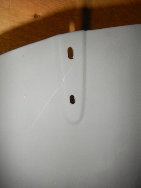

Here is a photo of my bonnet holes. This is how they came to me and it looks factory oval
David

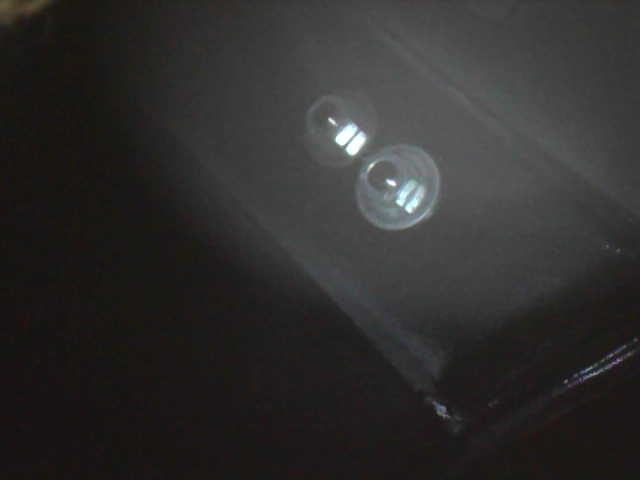

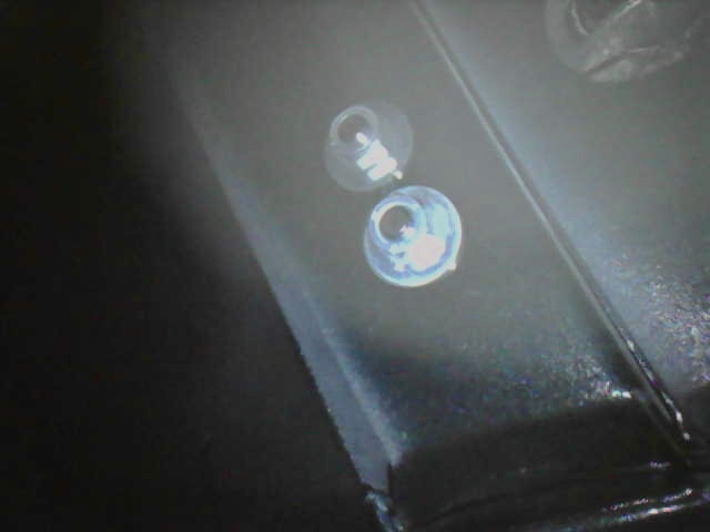

That job is finished.. took an hour.. only had to do the right side/passenger side (left hand drive car/USA). Removed the two body nuts first. Glove box is a little in the way but could reach up behind it. Had 3 friends steady the hood while I slipped my arm under the hood to do those. Had the hood/bonnet raised up just enough to squeeze under as I left the left/DS hinge attached. Not dropping nuts and washers and making sure to avoid paint damage is why it took awhile. Patience is key as always. Thanks for the replies everyone.
-These are the two under the scuttle, behind the dash (1/2 inch I think. Beneath the hood were a different size)
