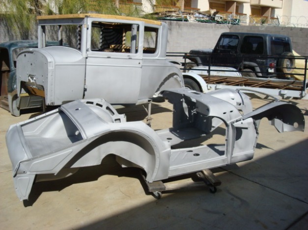

Quick photo of body shell after media blasting. Shell has since been primed and a few more small repairs to be done. Then to mount to chassis and trial fit everything, then remove it all again. Slow but sure progress.

That's looking really good!! Looks really clean! And what is the large car in the background?
Looking great, Mallard, imagine you will be anxios to get it home and start working on it!
I'm with Peter, what's in the background? Looks like a late 29's early 30's something or other. Kind of looks like a '31 business coupe I owned back in the early 60's.
Tinkerman
My guess is that it is a 31 Ford Victoria. It's just one of many projects that go thru Patricks Pro Strip in Mesa AZ. No worries when he strips your car. A free plug for him.

M.Pied Lourd,
He uses 120 grit aluminum oxide. It's a very sharp cutting material that reduces striping time to prevent damage to the metal. Most important is to find someone that works on cars not heavy equipment or heavy guage steel. Soda will leave a film behind that has to be removed. Ask for recommendations in your area from the local car clubs or go online. You will have to remove any undercoating yourself. Blasting will not remove it. Also try to get all the seamsealer off. $350.00 was the cost.

Maybe it's the perspective of your TR in front of that older coupe, but that looks too big to be a Ford. Height of the windows, width of the belt line, length of the roof, looks like a Packard, Cadillac, Franklin type body to me. Show the pic to the guys at the shop, let us know! :smile:
To answer 3 guestions.
1 I will strip the doors,wings,ect. by hand.
2 Pat I'm not sure yet about the paint still looking.
3 Car ID, I called the blasters and was told it was a 28 or 29 Cadillac
