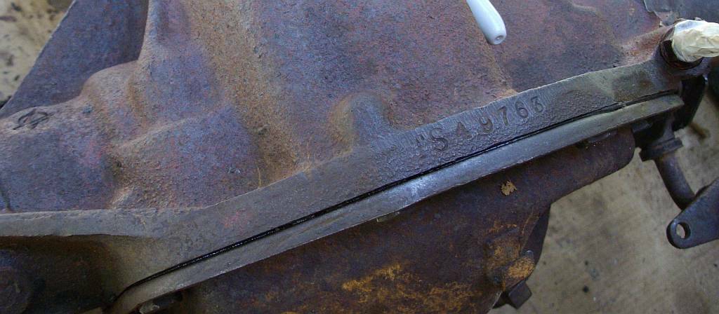

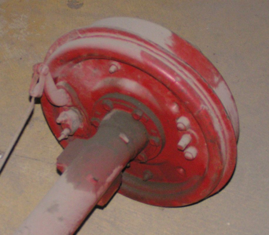

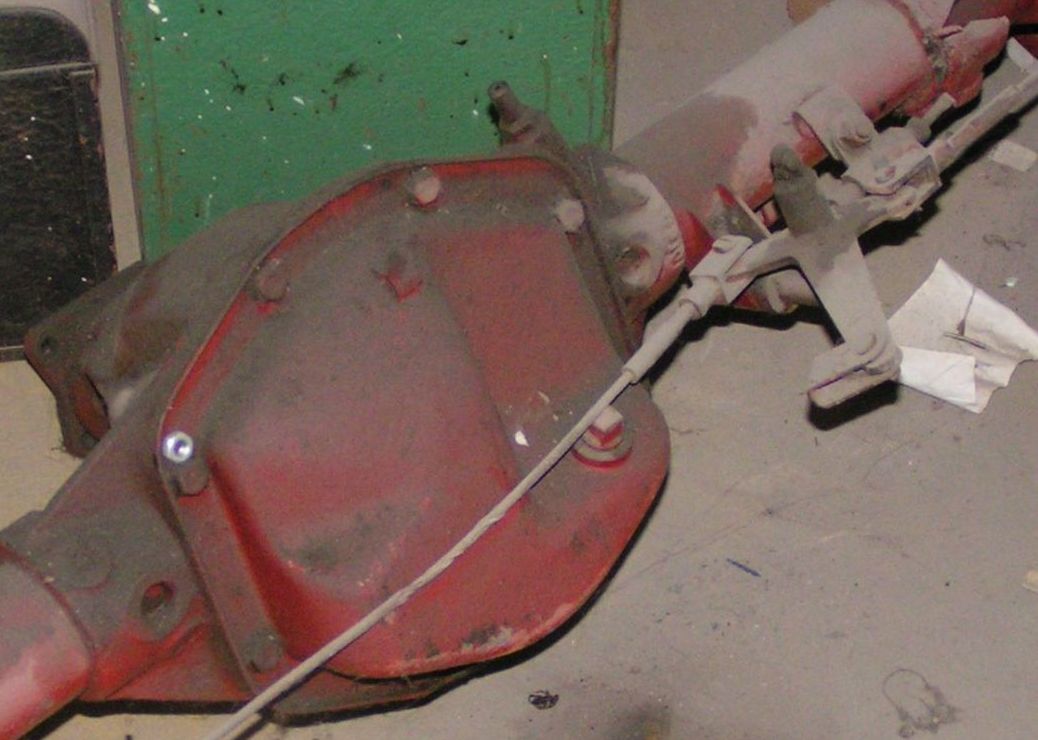

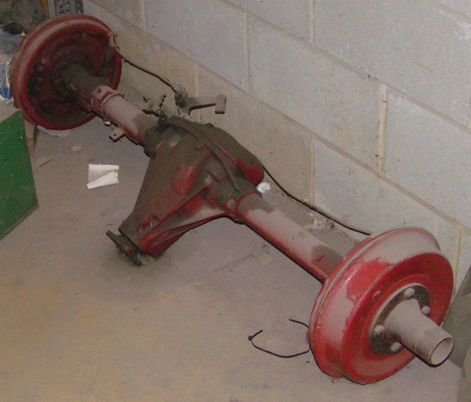

been sitting in the shop for 20 years, think its a TR3 (from TS13046). 41 inches from flange to flange. How would I know for sure it's TR3? Are there numbers hiding somwhere?

They look like Girling brake bits to me. And the spring pad spacing looks right to me for a TR3.
I forget exactly where the serial number is (someone here will know), but the prefix would be TS for a TR3 and CT or BT (3.7 or 4.1, respectively) for a TR4 axle.
I think they have a serial number right on top in the center of the pumpkin. If not, Moss has a good write up in their catalogue about types and numbers.
