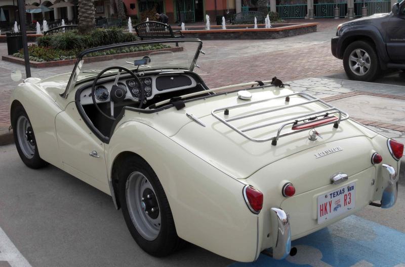

I chose a third LED brake light bar that fell out of a friends Celica spoiler during one of her accidents. A few days after another friend was rear ended in his TR3 by a pickup at a red light that didn't see him, I installed it on my luggage rack. It is much higher and more visible IMO. I drilled through the latch and wired it thru a 1/4 amp fuse thinking if the wire ever chaffs, the small fuse will blow and the remaining brake lights will function. It is attached to the rack with some plastic wire clamps and can be rotated up or down. It's high enough that I can see the reflection on the trunk lid in the mirror at night. I drive in congested traffic often and want all the visibility I can get.
