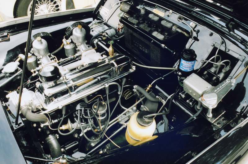

If the cast iron pump housing has no cracks, I'd go for that option. In 1987, I degreased mine during the restoration in white spirits (Varsol we call it here - or paint thinner) then had it sandblasted with everything else, then it was spray painted by the paint shop with all the other parts - all side by side like laundry on a clothes-line. After 19 summers of driving and 102,000 miles on my 1958 TR3A, the same water pump casing plus everything else still looks pristine clean.
toysrrus
Howdy Don,
Your Engine Bay looks "SOOOO PURRRTY"!! Have you entered it in the Calender Contest Yet? If not; You should. Got my "5 Star Vote".
Regards, Russ
Don Elliott
The photo of the engine bay of my 1958 TR3A was taken on concours day at VTR in Valley Forge in 2007. I was awarded 2nd in the early TR3A class with 384 points out of 400 (that's 96 points - the usual way). There were 8 competing in my judged concours class.
Don Elliott, Original Owner, 1958 TR3A, TS 27489 LO
