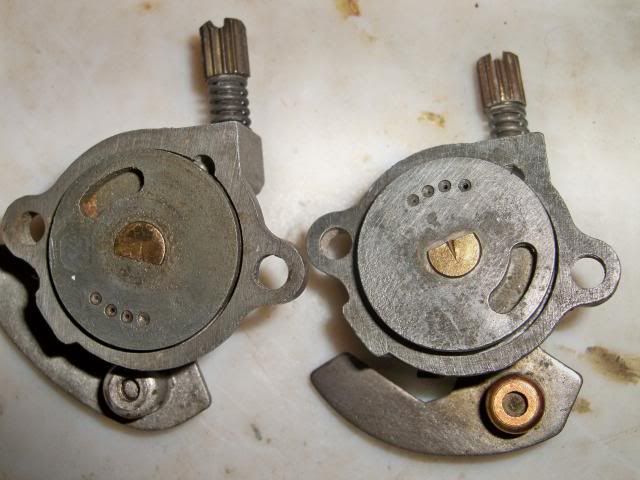

All versions have a cols start valve, starter box, whatever term you want to use..
You just said you thought you took the cold start valve apart...did you or not ?
If you did you may have put the disc back wrong.
In the left it is wrong on the right is the correct orientation.

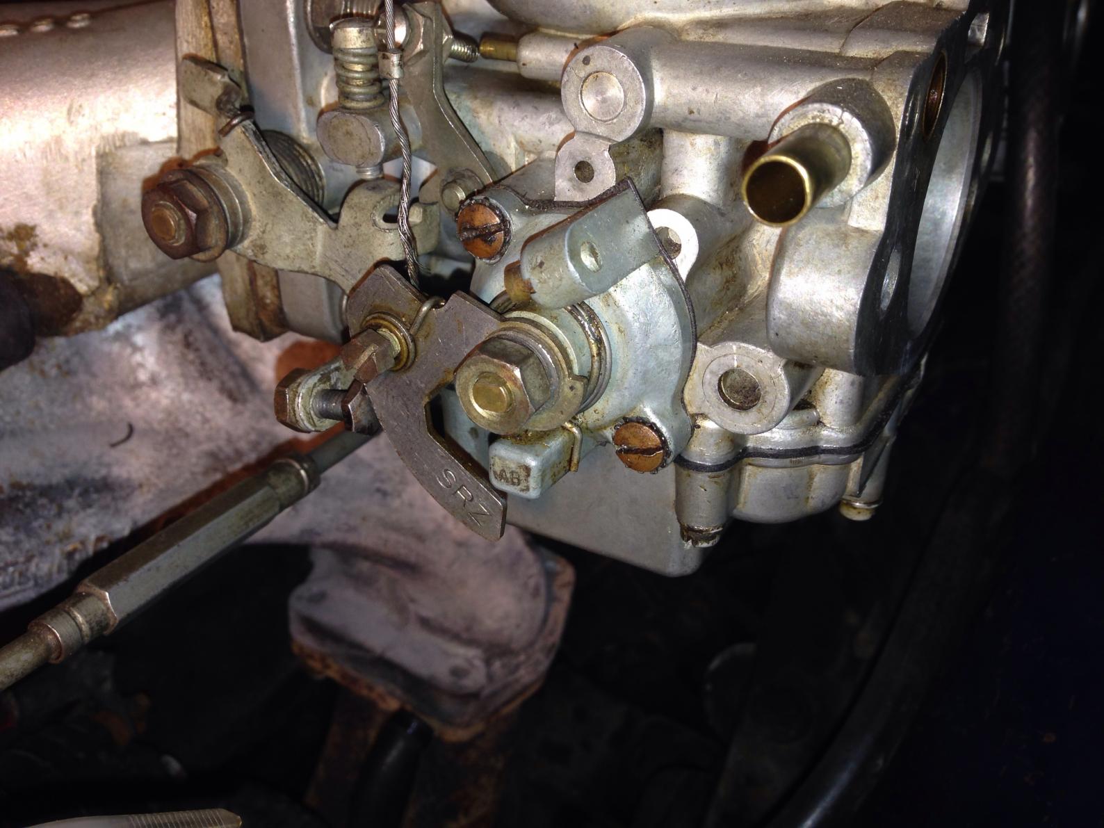

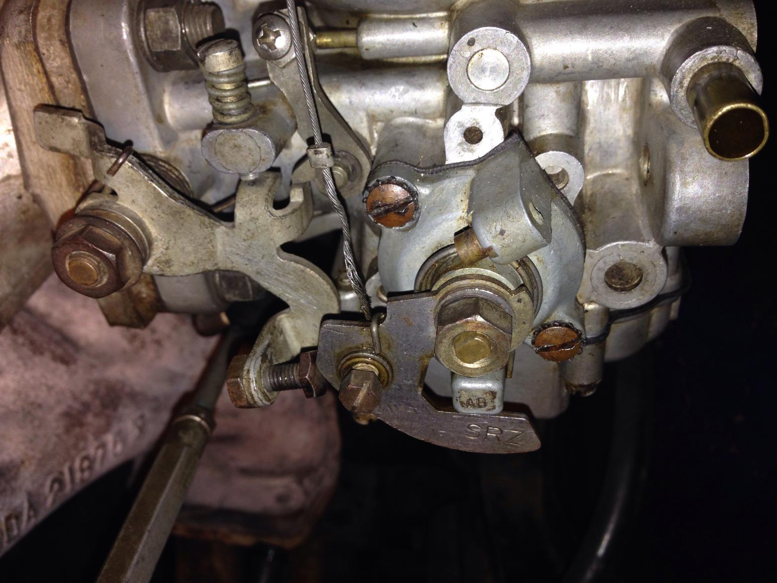

Take look at this adjustment.
The choke is partially engaged. Notice the gap between "B4" and "SRZ".
Is the HEEL of your fast idle cam JUST beginning to TOUCH the HEAD of the fast idle adjustment screw in this position ?

The one picture that looks likes yours is the rear carb and the other pic where it doesn't look like your picture is the front carb. Maybe that is my problem? If so how do I fix it? Sorry the pics are sideways.
If the choke knob on you dash is in the exact same position for both of those pictures, your front carb is much more engaged than the front..
That being the case, the cable needs adjusting.
Push the choke knob fully closed.
Loosen the clip that is holding the front carb's choke cable to the bracket that is attached to the carb and let the fast idle cam come to rest against "AB". Then clip the choke cable back onto the bracket.
The fast idle cams for your carbs (SRZ) need to be synchronized .
So, pull the choke knob until the heel of the rear carbs fast idle cam is touching the head of the adjustment screw, then turn your attention to the front carb and the adjustment screw's contact with the fast idle cam.
Even if synchronizing the chokes does not cure the hard to start problem, it's still something that needs to be addressed
Aside, I notice your choke cable is a little rough looking..make sure there is not a wire strand preventing the proper movement of "SRZ"
