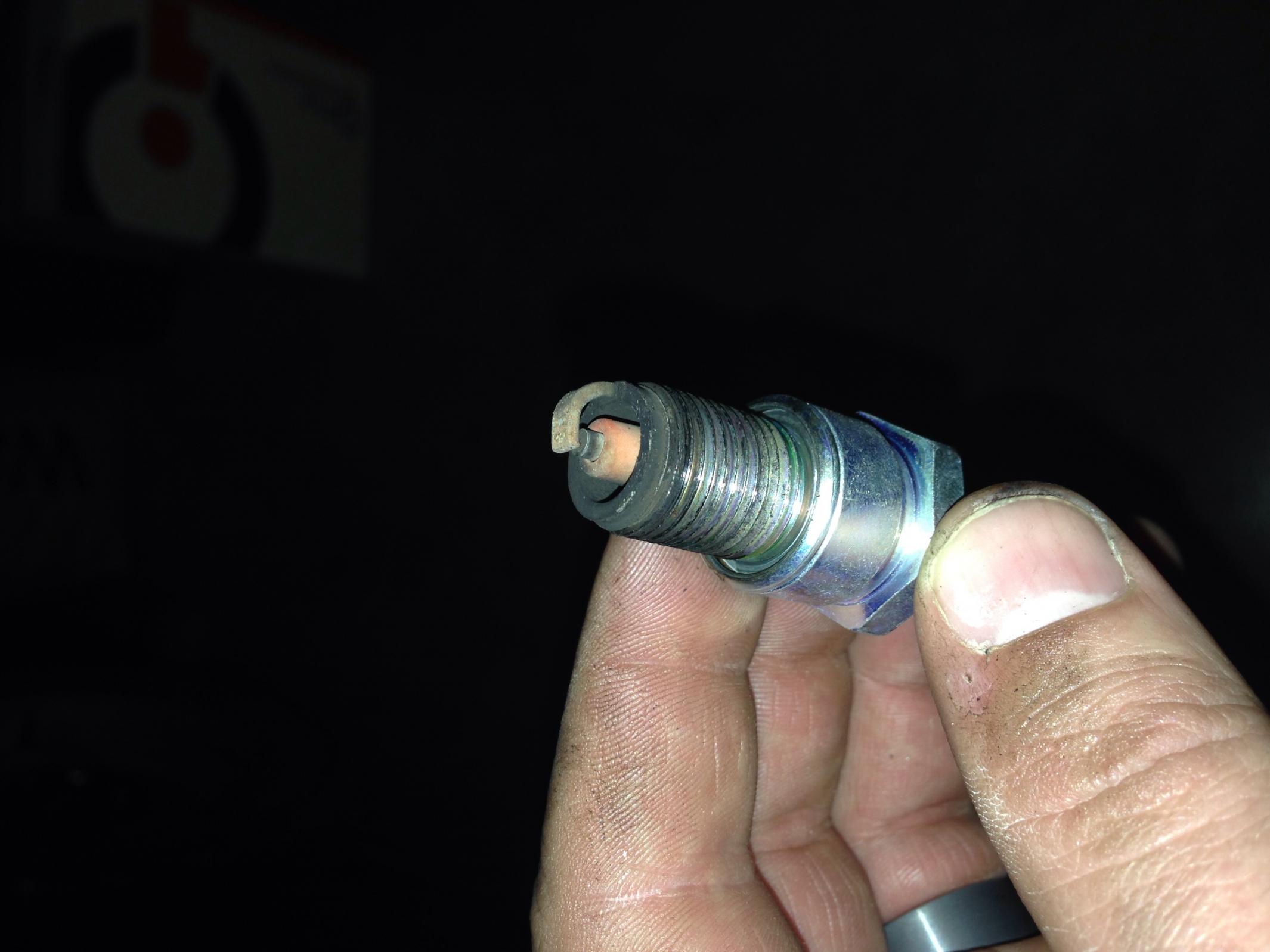

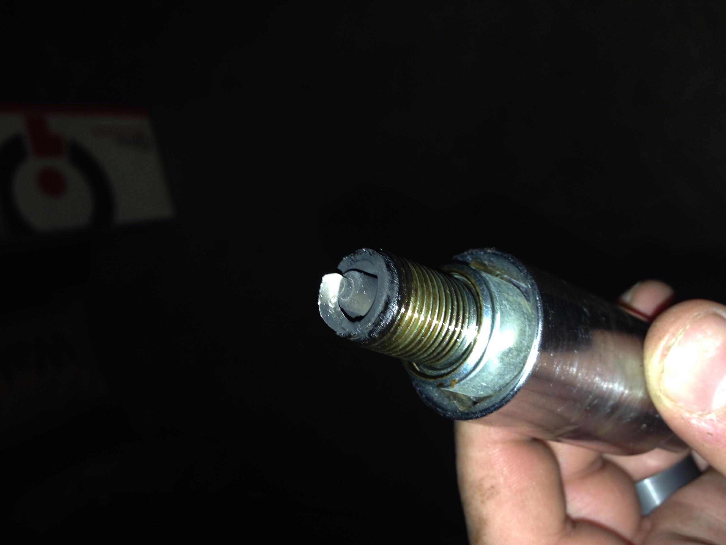

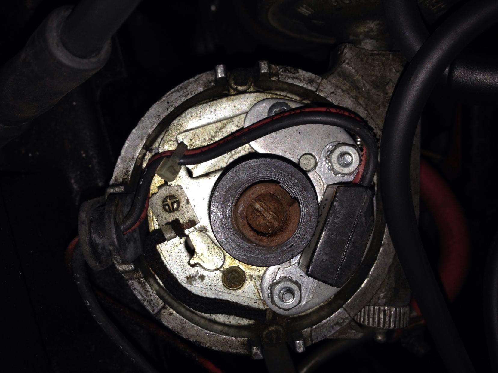

The first pic is from the back 1/2 of the engine, 4-6. Second is the first 1/2, 1-3. Third is looking at the distributor top. The middle screw is brown color kinda like rust color.
The problem is I tried to get the car started tonight and it wouldn't start. The other day when I tried to get it started it wouldn't start very easily. I had to jump it with another vehicle.
Poolboy I haven't been able to get the car running but the carburetor vent valve does open when I open the throttle.
I am lost on what to do now. I haven't changed the fuel lines, which I need to do but I would think the car would start rather the lines are bad or not. The fuel pump pumps fuel. Any help would be appreciated. Thanks

Looks like some flooding from the front carb.
Beside that, you should check to see if you are getting spark at all 6 spark plugs
I checked for spark last night and I have spark on all cylinders. This would mean my coil and distributor are working properly since they are providing spark to the plugs? I'm not sure how bright the spark should be. I guess I will YouTube a spark from a plug. The spark was a blue color which I saw was good. I checked the fuel pump and while cranking the car over it was pulsing fuel out of the hose to the carbs. After reading about mechanic fuel pumps this should be normal? The car still wouldn't start last night. Still frustrated!!!
You have spark; you at least have gas to the carbs, if not inside the carbs.
