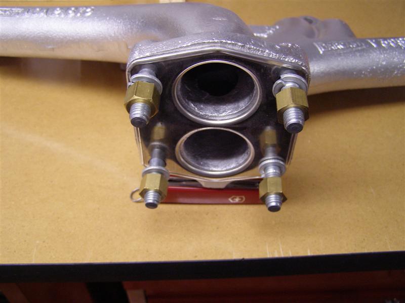

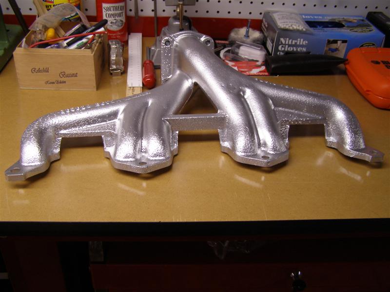

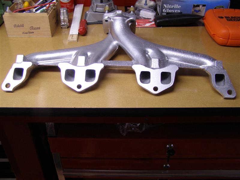

I'm not sure what year the "twin pipe" manifold came out, but if that is on a 72, I agree with Roman.

The exhaust manifolds are interchangeable, the exhaust port spacing never changed. The dual outlet manifold does flow better though.
The intake manifolds are a different story, the port spacing changed for the 1972-on cars and the intake manifolds, while they will fit from early head to late head style, have obstructed flow when they are mismatched between early and late.
