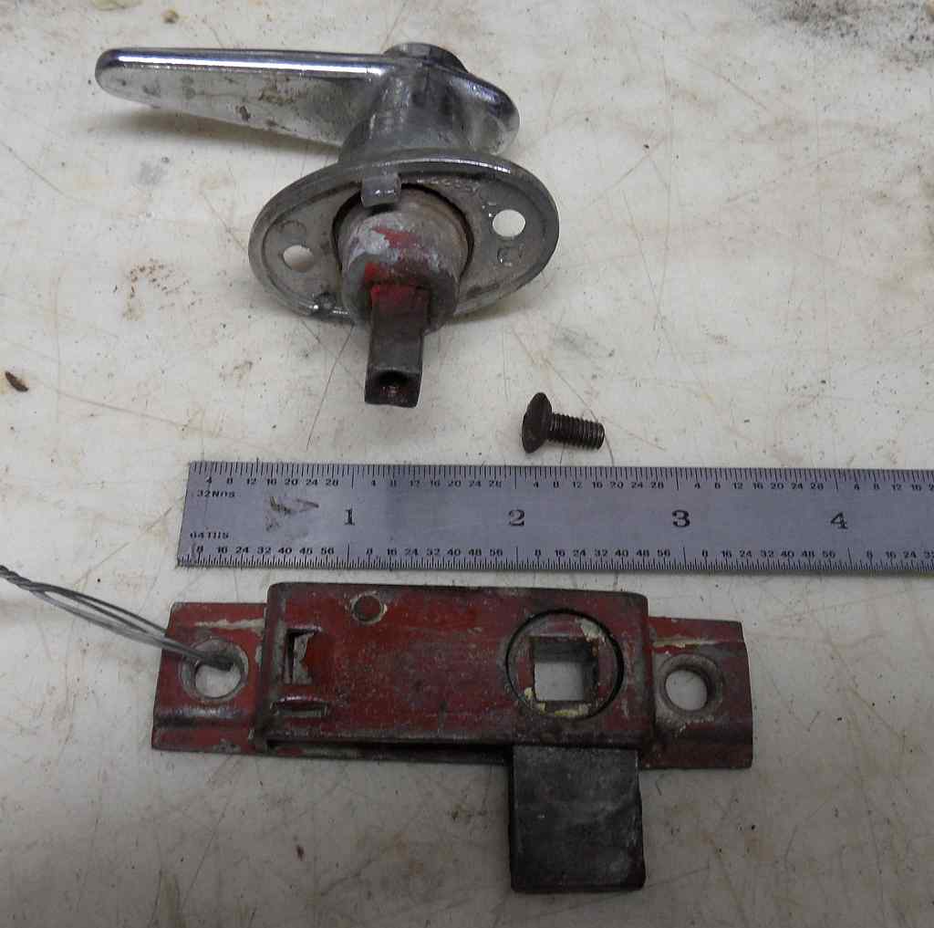

Can some one please post a photo of the inside of the trunk latch. I took this apart years ago, project got side tracked due to daughter's illness, now back at it. I bought new latch from TRF and took my old one to one of my houses 788 miles away thinking I did not need it. What parts do I need for the inside and what do they lok like? Thanks
This what you're looking for?
If it's not obvious, the handle and the tang are parallel, that gets the handle pointing rearward when the boot is latched.

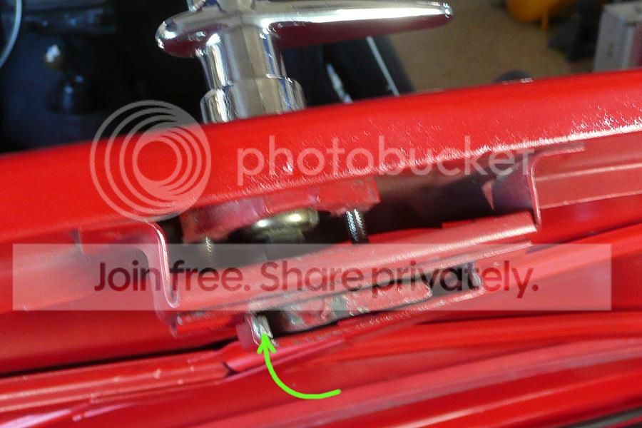

Here it is in place:
The arrow points to a bit of metal I had to add so the latch would be pointing straight back when closed (would otherwise been cocked slightly to the driver's side.

The handle should point back/down when the latch is closed. IIRC there should be a stop built into the handle base, but there is certainly nothing wrong with adding one to the latch as Geo shows.
