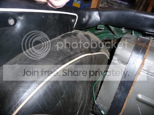

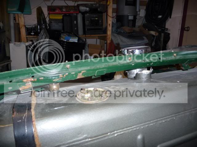

Here are a couple of pics of the felt on the straps if they help.
Cheers,
M. Pied Lourd
