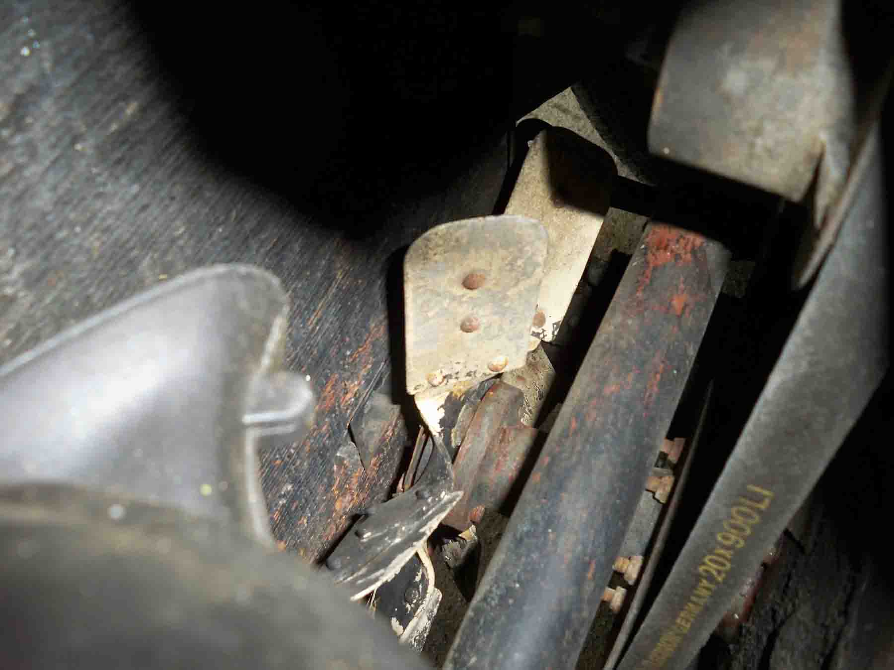

I was going to use the Moss plastic fan and it took me years to convince myself to buy one. I wanted to keep the car period. (Still using a generator too). When I went to our local Triumph guy to get a fan he suggested using a GT6 fan. It is metal like the 3's fan and has a larger pitch and 5 blades. Best thing I ever did! Never a problem with overheating and no one has ever noticed even being judged in a car show.
