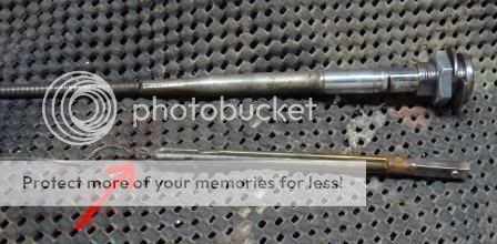

OK Guys. How do I get this broken inner cable off and a new one on? It appears to be soldered and crimped, but I'm not sure.

What I have done in the past is heat it up and pull it out. Then, I went to a guitar store and purchased the appropriate guitar string and soldered that in.

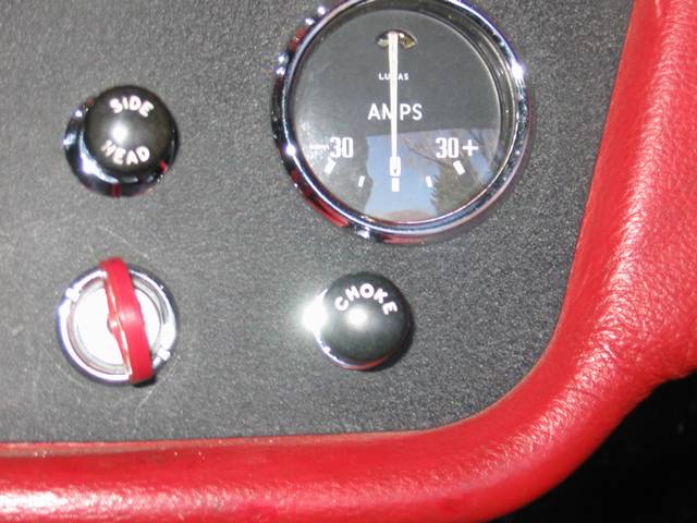

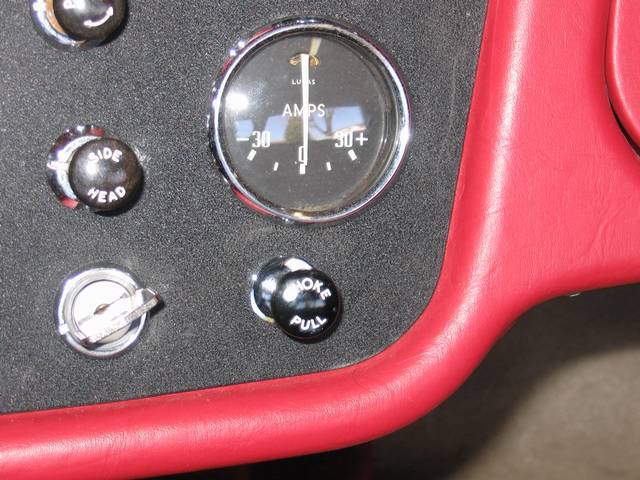

I'm sure that the price for a new one is cheaper and faster. Make sure you keep your original choke knob. The repro knobs tell you to "PULL CHOKE" whereas the original tells you "CHOKE".

go to a bicycle store the have lots of cables and different thickness cables and you can buy just the cable and not the black outer housing unless you need it, thats where I got my choke cable, like said heat it up and pull it out, if you have a oxy acet torch then braze in the new one

I second the bike shift cable as a replacement, also setting it up for the front carb only. If you're really good at brazing, OK,but soldering works fine. After you get the old cable out, drill out the hole to the same size as the new cable so you can get an easy insert.Cut your bike cable to correct length & tin that end so it won't unravel.
