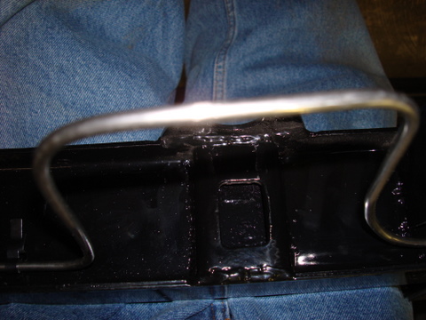

Here is how it's done. The photo is from Menno in The Netherlands. He added the extra clips which I did not add on my 1958 TR3A, nor on the late TR3A I finished in 2006. There is a clip spot-welded to the bottom of the floor pan to hold up this brake pipe where the dog-leg makes the two closer middle turns.

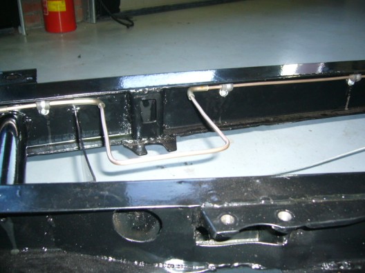

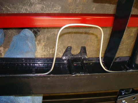

Agreed Not such a tough job! :yesnod:
