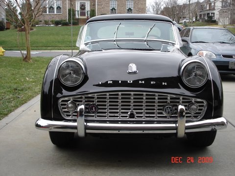

My 59 had lots on EVERY panel. After my nip,tuck,liposuction,and panel replacement
I still have some skim coats, but a lot less overall.
The body shop said I should get 4-5 more MPH after the removal of all the bondo!
Gordon
